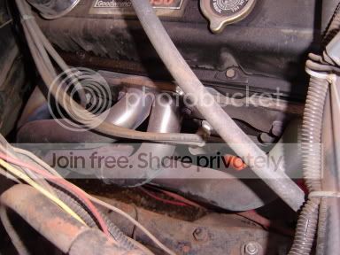

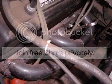

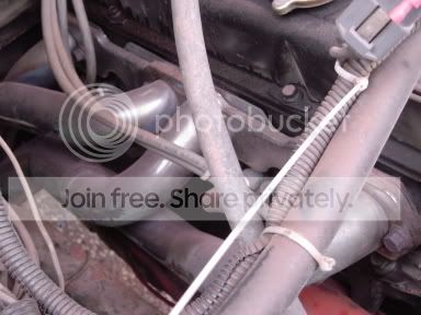

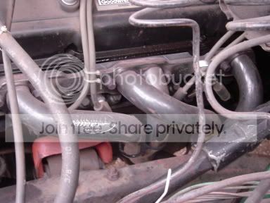

I have them on my '73 K5, with no clearance issues whatsoever. I can't get all the sparkplugs with a socket wrenck, I have to use a box end on a couple, but I like them, and after 25,000 miles, there is no rust. I bought mine from summitt.
Can you shoot a few pics? Do you have any problems with the spark plug wires touching the headers? What model number did you get?
Here's some photos. I have no probs with the plug wires hitting, you can see how I bundled them in the photos. I think thee model was the thy-364Y, but mine did not come with a y-pipe. It is not available for the '73 K5, I don't know why.
