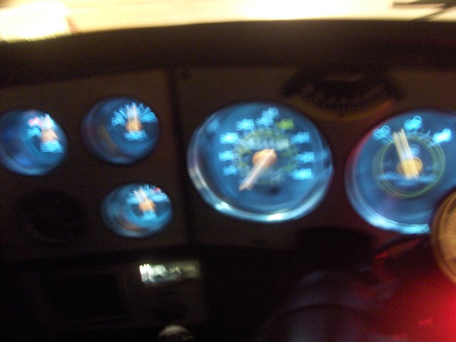

As other has stated the Superbrite LED’s can be dimmed with the factory headlight switch. Didn’t need to add any additional resistor. I was very surprised to find the actually dimmed with the factory switch after I installed them. I used Natural White Superbriteled.com WLED-NW5 in both my ’78 K10 and ’89 V2500 Suburban. They work great!
Here is a sucktastic picture of the ’78 K10 in the dark. I just need to put one of these bulbs in the tach now. You can kind of see the lighting difference between the incandescent bulb in the tach vs. the LED’s in the cluster
Lol you sure do! Thanks man! I might just try the leds in one truck and the chrome paint and bright bulbs in another and see which I like better.
