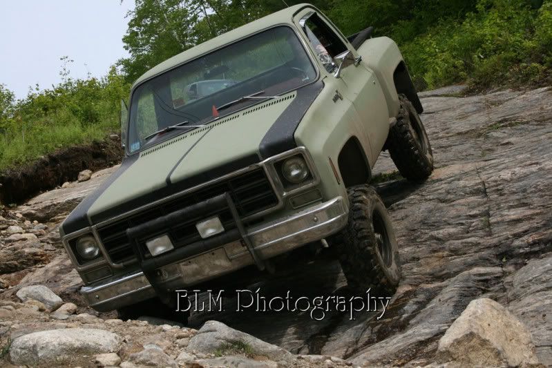

Depends on the lift IMO. These 35x10.5's look cool on my CUCV with no lift, but I think they look weird on my K5. I'm going to at least 12.5 soon.
83, they look way better on yours then they did on mine, Probably due to you having factory rallys, and I have the factory steel wheels.
Although I do really want wider wheels with some offset, either factory rallys or CUCV wheels.
Stock base tire (at least for the years I'm familiar with) on 1/2 ton 4WD was 9.25" wide, optional being 10.5" wide.
Unless you turn or flex the suspension (as shown above) you don't even really notice the height vs. width. They look no different from stock straight on.
