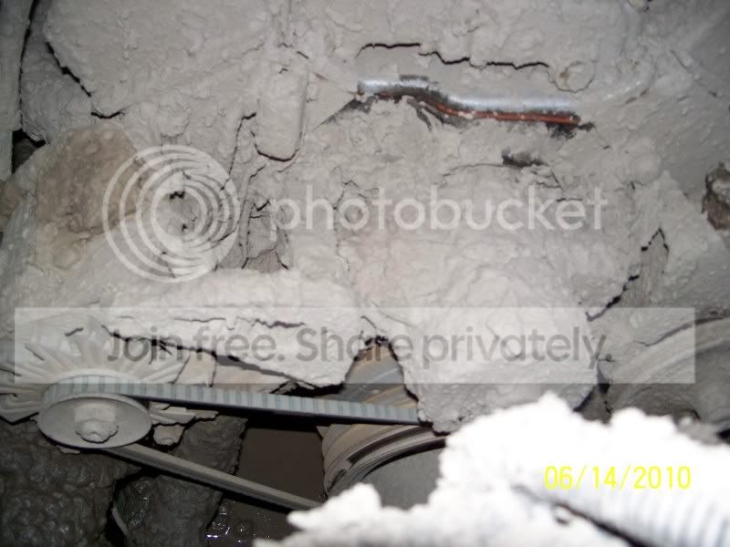

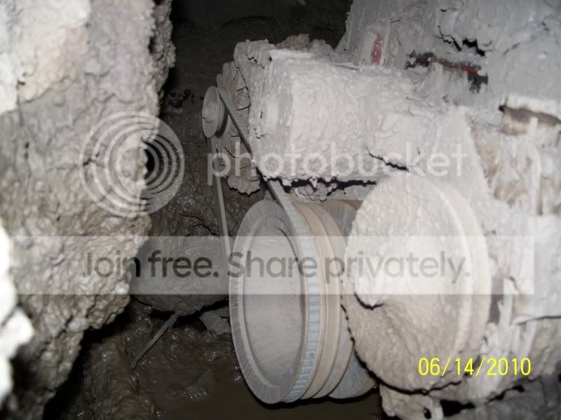

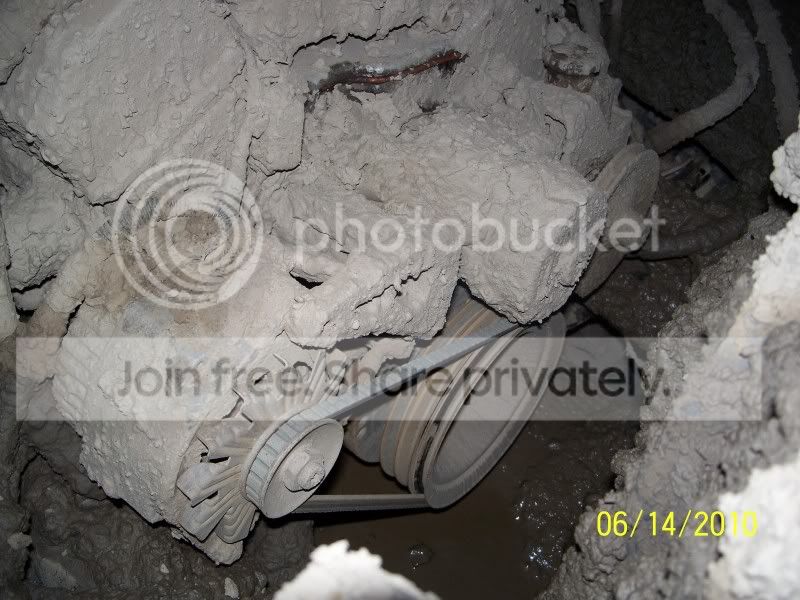

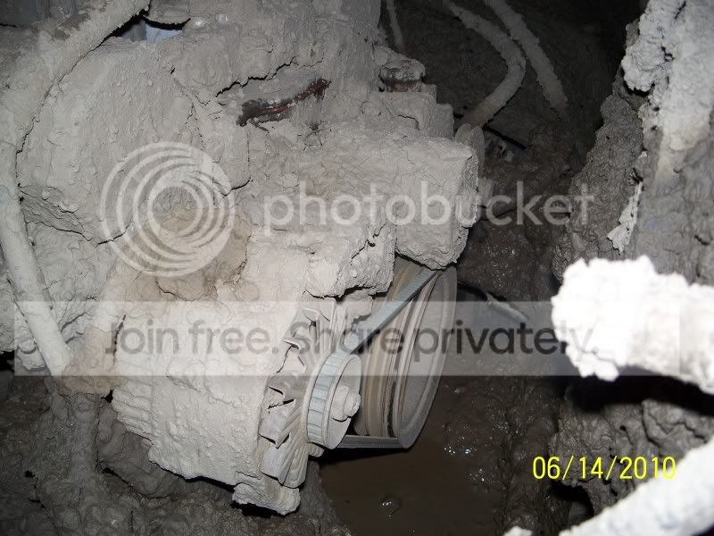

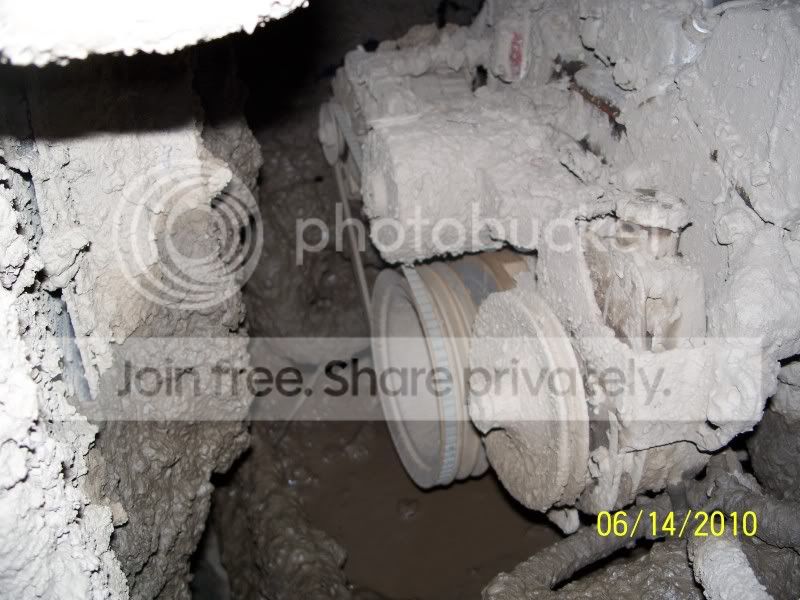

it's a little dirty yet. i think the alternator got closer if anything.
http://i130.photobucket.com/albums/p276/YZEATER/85 chevy 1-ton/100_2566.jpg

Looks like you got a problem with the main pulley.
Compare the wear marks on the alt with the marks in the picture of the main.
You have a nice smooth even mark on the alt, with interruptions on the main.
Where you don't see a mark, the belt is not touching for some reason.
Probably bent.
It does not look like it is from the pictures, but be sure the belt is not bottoming out in either pulley. V-belts depend on the constriction of the sides pulling down into the grooves for friction. I don't see any wear marks on the bottom of the grooves, or belts, but I have often seen folks accidentally get too thin a belt and they slip.
At high speeds, a slight "bump" in a pulley will cause a belt to throw. When the system is running slowly, the belt rises up on the bump and tracks back down. But all things have inertia. When the belt gets thrown up on the bump fast, it can keep right on going up and off.
Check out where that interrupted mark is and see what is keeping the belt from touching there, and I think you will find the problem.
J.
hmm, all that mud on there might help finding the problem. i'll check it out tomorrow to see if it's bent or pinched.
