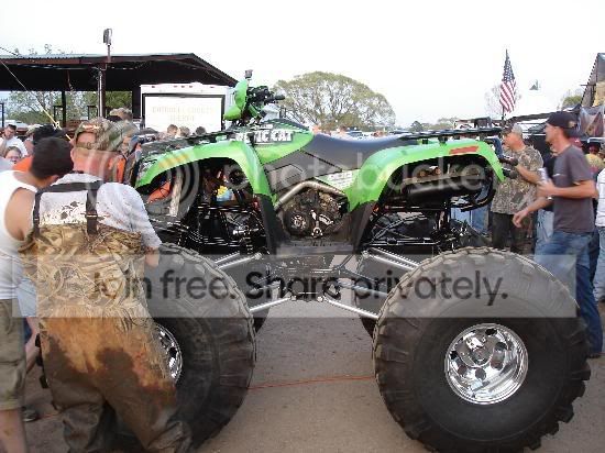

Tire pressure is relative to the weight of the vehicle and size of the tire. Just think of your weight being distributed over the tire's footprint area as the lbs per in^2. And it must carry through to some extent to bead retention. So moving to a smaller tire will give you higher ideal pressures. This guy probably doesn't even need valve cores to retain the beads.
(wonder how it steers)
