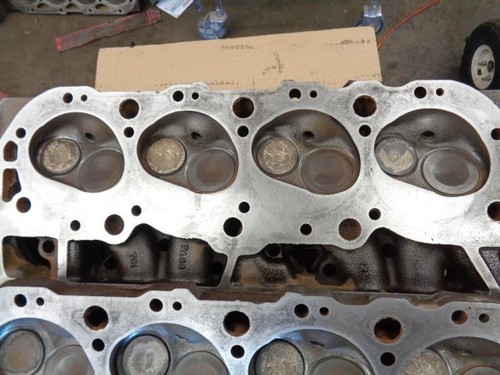

I'd call Northern Auto Parts in Sioux City Iowa. They can fix you up. They gave me all tye parts I would need to do a 383 short block for $650 These were mostly speed pro parts.Hi guys. I am really in need of some direction. I have a 454 out of a chevy 1 ton. It has tbi and i am ditching all of that. Block casting number is 10068286 which i have for to correspond to a 1990 mark IV short deck 4 bolt main block. Head casting number is 14092360. I believe they are F229 and are the peanut heads everyone likes to trash talk online. Intake casting is 10052952.
So now on what I would like to do. I want to open up this motor with doing heads, cam, intake, headers. I want to go back to carb for simplicity for now. smog is not an issue. I would like to raise compression with heads to 9:1 or somewhere around that if possible. I was think afr heads with a air gap intake. I just really want 4000 to 500 hp with lots of torque on the low to mid range. Redline should be around 5500. I really just neew help on picking out the right parts to accomplish this as all the research i have done says that you really need to get these components that will work with each other or its like throwing money down the drain.
Any direction will be much appericated
