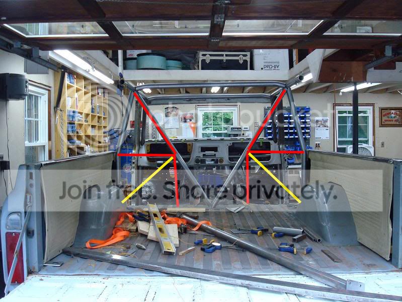

It seems he wrestled with those diagonal bars supporting the b pillar. Chefbear's solution doesn't seem to add strength to the cage, but provides a mounting point for the harnesses and makes walking through between the seats really easy. Greg's solution obviously adds tons of strength to the cage at the cost of rear access - though the rear is still accessible. Bigblock72 http://coloradok5.com/forums/showthread.php?t=222300 doesn't appear to run any tubing near the interior and doesn't run 5 point harnesses (and I have a ton of respect for him, the work he does, and the help he has previously given me).
I always assumed that I would run 5 points, but maybe Chad has the answer. Here's a thought. Would it be worth it to make a compromise between greg's cage and chefbear's cage by doing the mini-hoop behind the seats like chef did and then running a bar from the corner of the b pillar hoop to the corner of that behind the seat hoop? Or would that be tube for the sake of tube rather than actually contributing to the integrity of the cage?
Strength vs Aesthetics vs Real-World Functionality is a tough balancing act in rollcage design.
Ultimately, it ends up being as many tubes as you can stand installing and still have the access you want. The b-pillar supports are hard because they really DO help prevent the cage from shifting laterally during a rollover, but they immediately limit rear seat access.
In practical terms, since I knew I'd be running a center console there was no reason to give clean access from the center of the truck. In the old days, it was convenient to stand up from the driver's seat and move into the back through the center, but now the console makes that an awkward move anyway.
If you keep the factory style flip-forward passenger seat (or at least use a similar mounting system on an aftermarket seat) then a design like my diagonal b-pillar bars isn't really all that impractical..... it's a pretty good angled shot up into the truck and then into the seat behind the driver. The minor inconvenience was worth the tradeoff for me.
As for 4-point belts which I do eventually want, there should be a way fairly easily to install a small horizontal bar inside each of those b-pillar supports just below shoulder level to get a proper mount for the shoulder straps. If space gets tight for two straps, I think they make a version of the belts where they come together in more of a "Y" shape so that you only need to have enough space to bolt a single strap.

In other news, Greg's thread is entirely too long!!
The red lines are what I was thinking as far as comprimising between the two designs. The yellow line was to add strength. What do you guys think? I think rear access will be through the center, because I haven't really ever used the passenger seat folding forward, so why start?
Maybe.
In a rollover, none of that bracing is a single solid tube, it looks like a bunch of small segments that would not have the same ultimate strength as a single straight bar. The problem I see is that you've got a cage node with 4 bars intersecting but it's not supported in any other plane....so what's to keep it from pulling forward or backward?? If the yellow bar was run to the base of the rear wheeltub, instead of the base of the b-pillar that would strengthen that design.
Ulitmately, those short vertical tubes off the floor add very little to the design...If you were adamant about a walk-through design, it might be better to simply run the support bars like I did in my original design, but just put space between them where they land on the floor (Maybe 12" - 16"). You can still support it with the horizontal bar and even the yellow bar if you wanted to.
Also, your sketch shows a really wide walkthrough....more than you'd really ever be able to use with seats installed. If you redrew that image with a more realistic dimension, some of the angles might end up looking a bit out of proportion with your current design.
:usaflag:
I think if you mockup gregs setup, that V in the center would be easy to walk through if the console wasn't there. You can just grab one of those bars and step through/over. Get a little PVC tube and try it out. If you use the folding seat like me, I've got about 30" of space between those posts on the floor and its plenty o space to walk though even with the console there.
greg - Yeah, the slightly wider V makes more sense than my sketch. Thanks for explaining the feedback - it really helps with understanding.
bp - I think I could walk through Greg's fine, but I have a few reasons why I would want a bit more space there. I couldn't quite picture what you were talking about in the last sentence, mostly cause I have no idea what your cage looks like. I tried searching for some of your threads, but you have too many posts (too helpful I guess). Do you have a link to another thread where your setup is pictured?
Thanks for finding that for me. I love the CAAD drawing of your cage, way slick. Do you feel like the extra tubing at the b pillar really adds much strength with how close they are? I could see how that setup works great with the seat flipping forward too.
Another (unrelated) question for the masses: is there a way around doing some sort of vertical support between the B and C pillars or is that a terrible idea?
