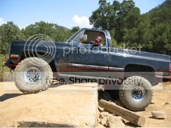

Here are a few pics of mine. I cut back to the inner fender, and under the rad support. I still rub but just on my inners so no biggie:wink1:
It looks like what you did is EXACTLY what I want to do....I wanted to cut the back of the rear fender up and the front of the front fender up like you did and cut out the rocker and put in that long piece of steel that goes front fender to fender.
