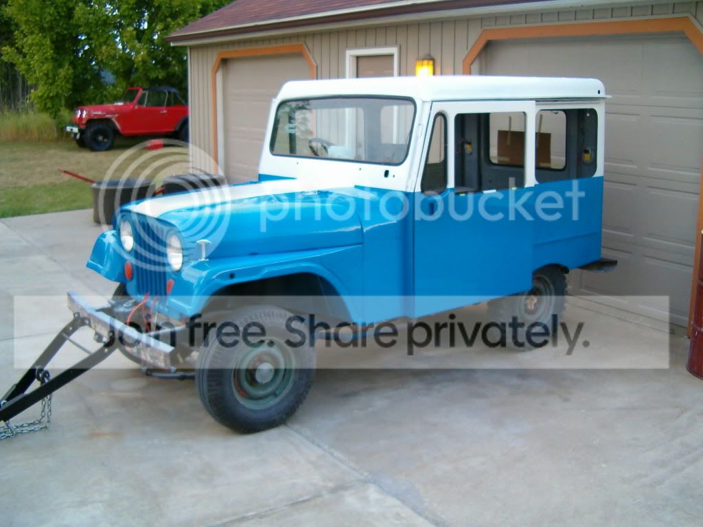

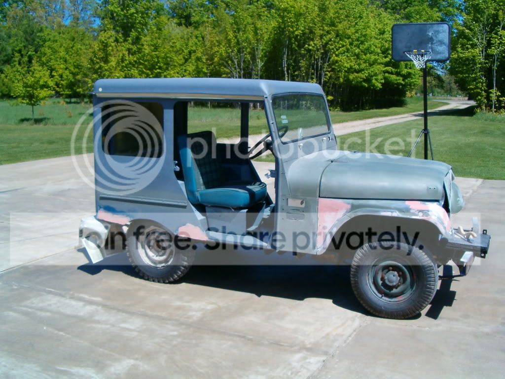

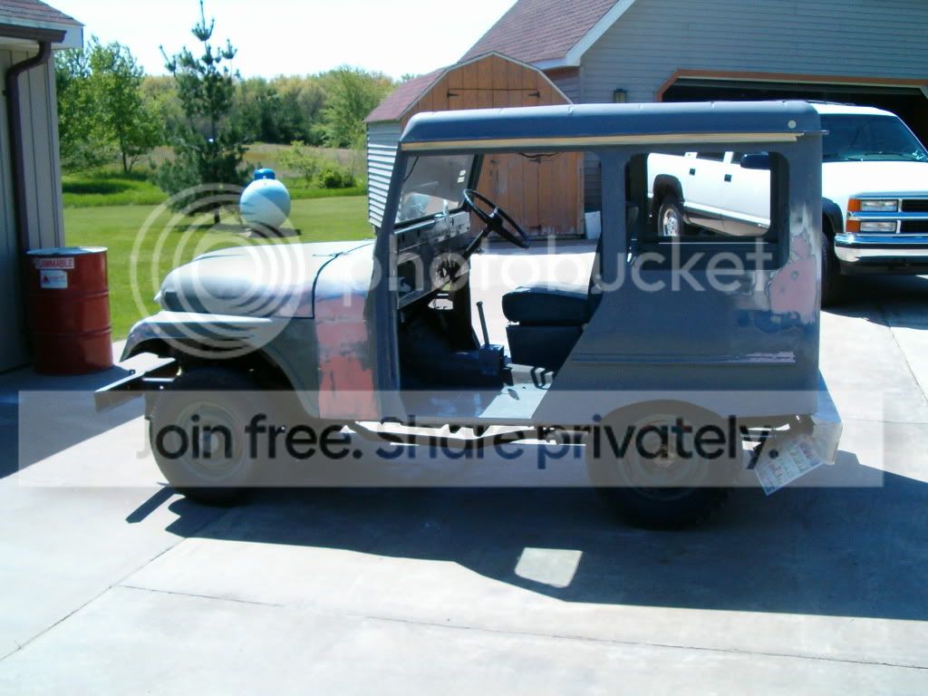

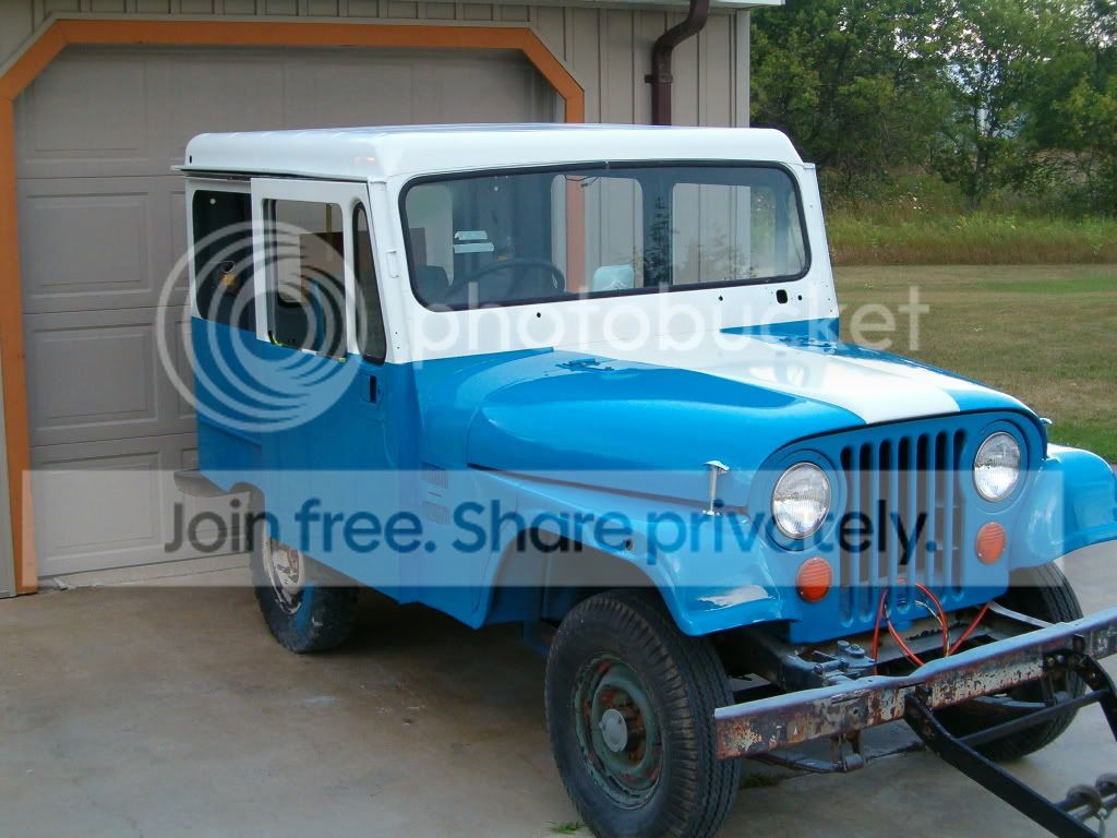

finally got the pics to load up....this is my Dads' Postal DJ-2....Dispatcher Jeep....he was a letter carrier for 23 years and just has an attachment to these things, that I guess unless you've been there its hard to understand.
4 cyl. Chevy, with a powerglide, and a D44 rear axle.
before and after
Anybody who's been spending a lot of time doing bodywork can appreciate the flat panels of a Jeep like that. :D

Well there not as flat as you would think, you see when Kaiser built these, they pretty much threw 2 pieces of metal together, hit it with a bunch of spot welds at high heat, because every damn panel has a bunch of those dimple warps in it. I didn't worry to much about those in particular, just the "additional" dents I took care of. Pop was really happy with it.
