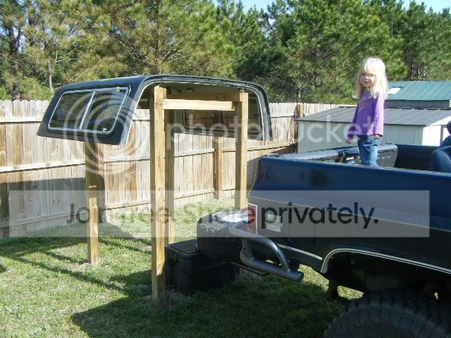

I posted pictures of this last fall on another site, but here are some better pics of my solution to one man top removal. My truck doesn't really fit in the garage for the hanging method, and the wifey is not too keen on me backin into the ditch in the front yard and asking her to help carry the top off the truck.:bitch:
She actually had a very large part in this idea.:cheers:
These pictures were taken as I was putting the top back on today. Although it was 80 yesterday and today, the high for the weekend is going to be sub 60.:(
I use a action packer to let my stinger slide back as I back up to my rack.

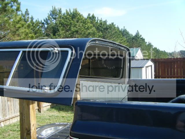

Here's the best pic I took of the rack. Just four 4x4s with rubber casters at the top. I also framed them together more strength, and it lets me slide the top back by myself.
Drop the tailgate and back up as close as possible. The use of "spotters" is optional.:character0182:

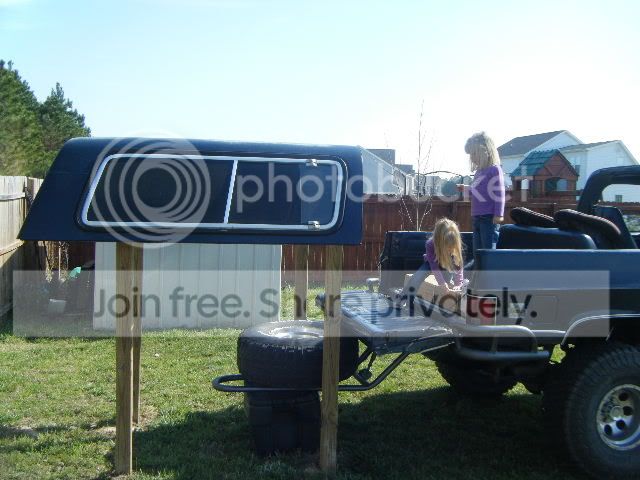

Now, standing on the ground, I lift the rear of the top over the rear casters and walk it towards the truck.

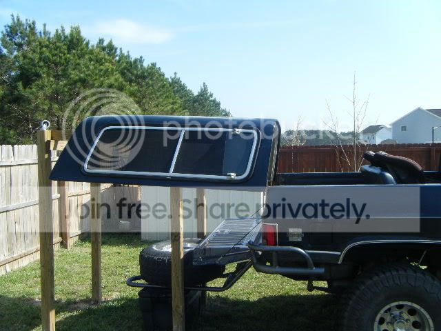

With the top resting on the front casters, and the frame, this is as close as I can get to the truck.

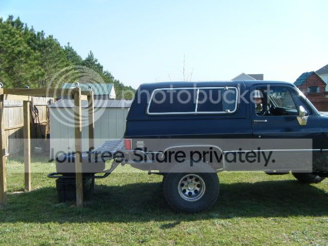

From here, I get in the back of the truck and lift the front of the top onto the bed rails and walk it on, until the rear of top is at the front casters, then I do the squat and crab walk with the top on my back.

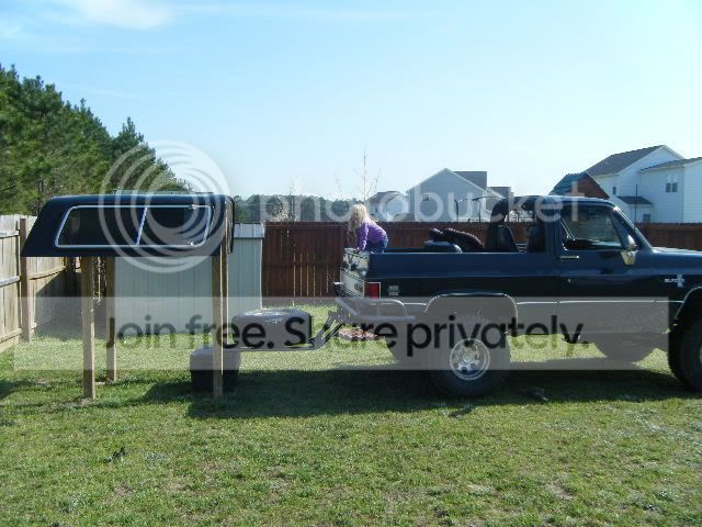

Removal is exactly the reverse!
It takes about 10 minutes for me to do by myself, and 1TXChick didn't complain about the money for lumber as long as I wasn't going to ask her to carry the top any more.
