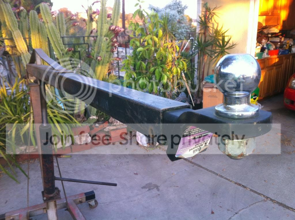

I started with this - engine hoist (non-folding with extendable boom and legs) and a ball hitch. Its interesting that after removing the bolt and chain it fits in the boom perfectly.

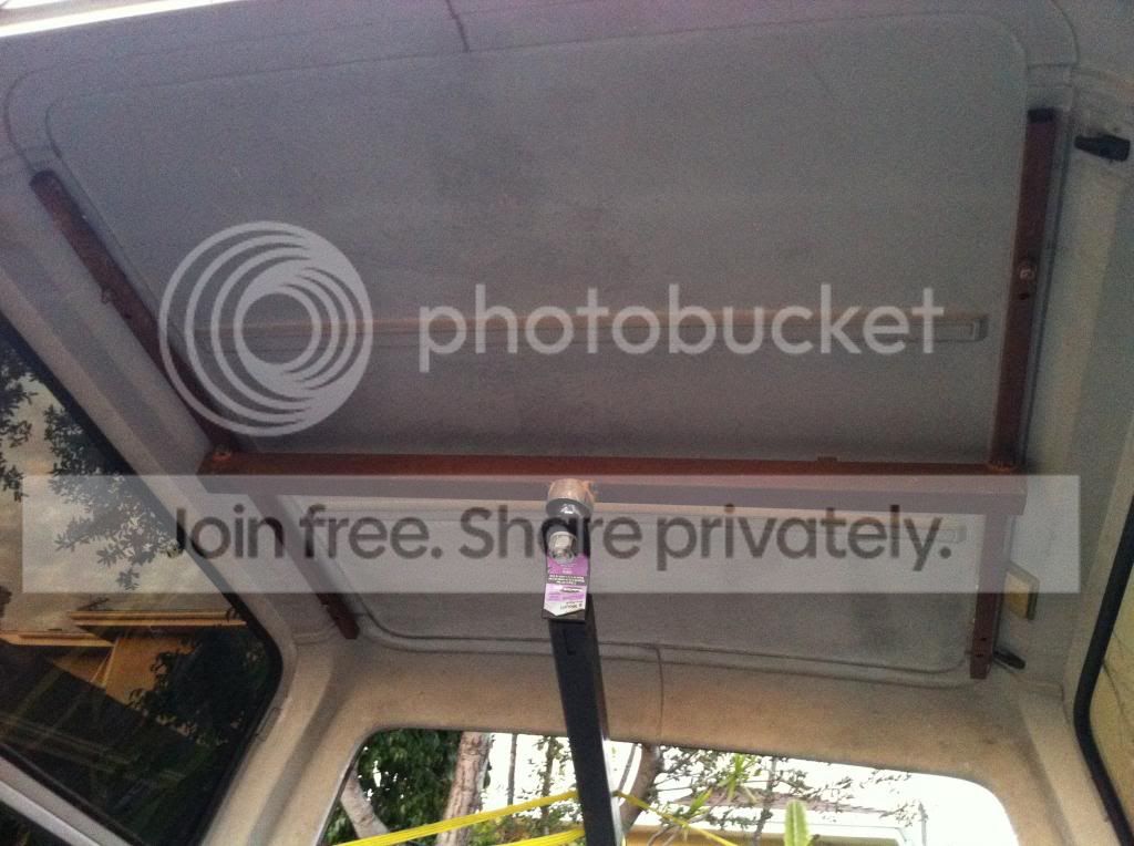

I had some scrap steel mostly 1x1 and 2x2 so I made this "H" frame that bolts on the inside of my top since it was drilled at the dealership for a factory rack that has long vanished. I built it in a way that the center of it lines up centered on the top (front to back and side to side). The round collar in the middle is a scrap piece of 2-1/2" exhaust pipe. Forgot to mention, you can't use this method if you have a full roll cage. I also wouldn't recommend this if your top is not drilled since it's imperative the frame does not shift.

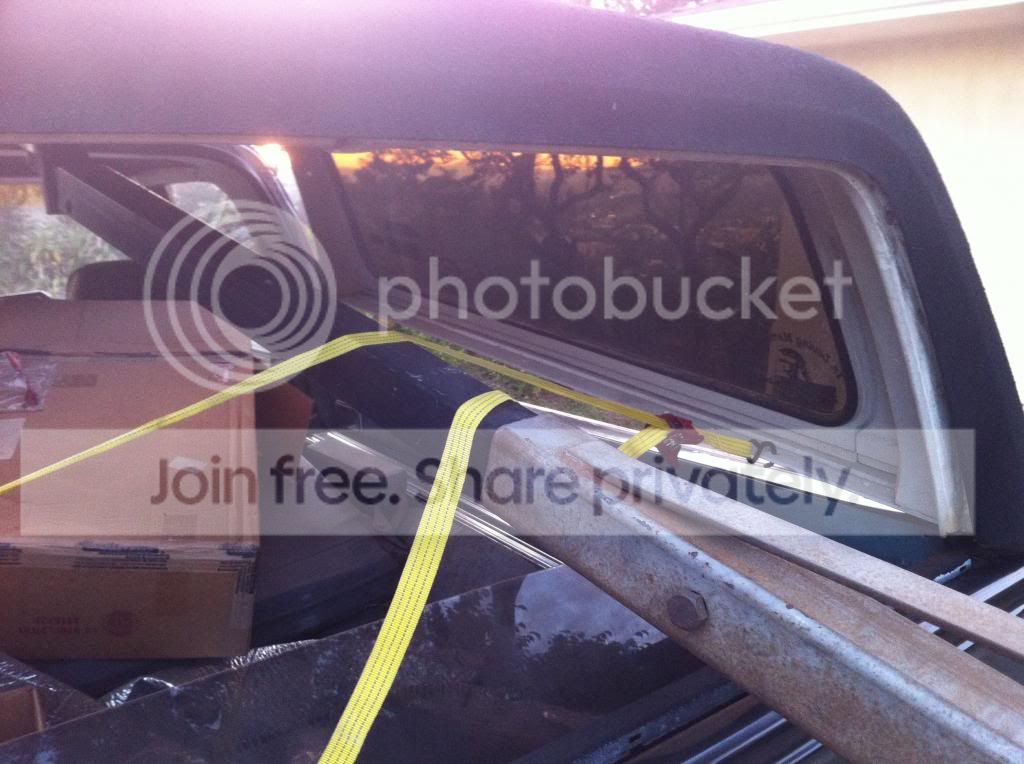

Raise the boom of the hoist so it can go through the rear window (with tailgate up)and the ball contacts the frame. Start lifting...

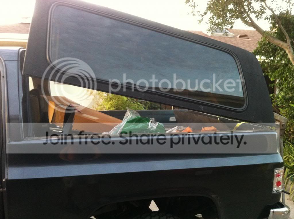

Due to the construction of the top, the tail end is heavier. To get it to rise up, I attached a cheap ratcheting strap through a couple of bolt holes and looped it on top of the boom and ratcheted it tight until it lifted up.

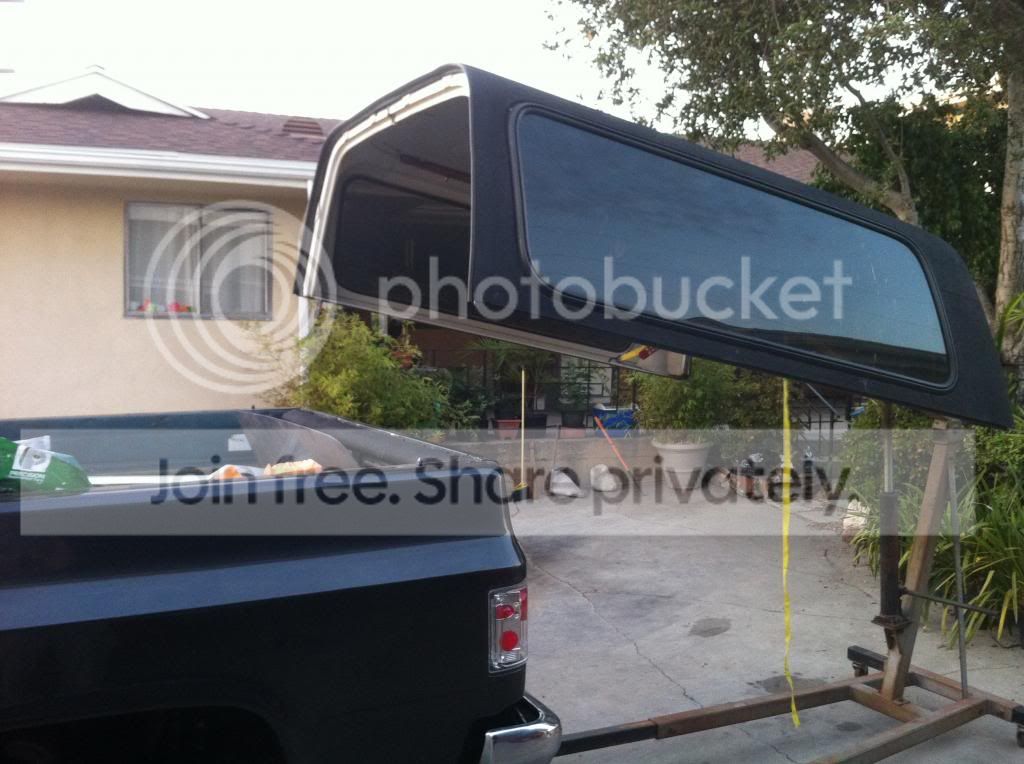

lift the boom a few more inches and drive the truck out from under it...(PS: don't try this if it's too windy).
the top will naturally center itself (side to side, like a horseshoe on a nail). It's front to back that you need to worry about so make sure the boom always stays centered in the rear window area of the top. Putting it back is reverse - the conical "studs" in the rear help line the top back up. (Note: my blazer has a 4" lift and 35" tires so I think this would work up to 6" of lift).
