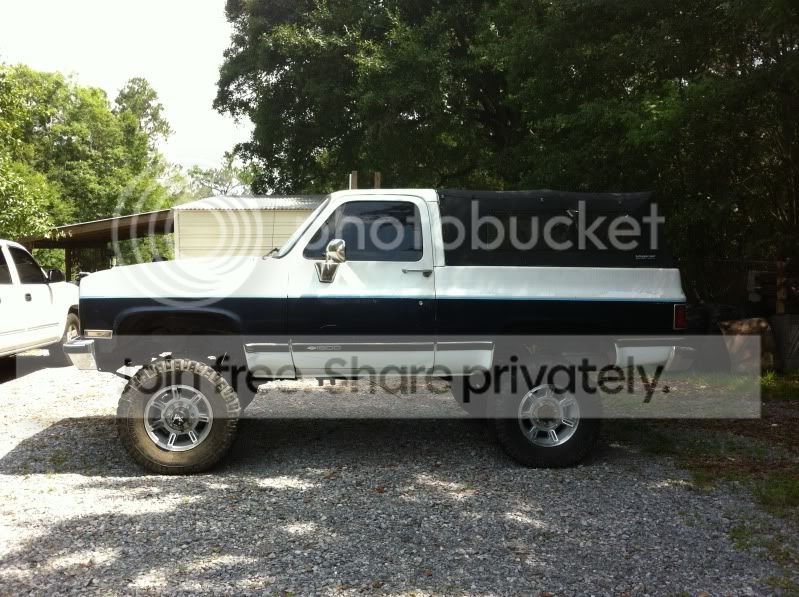

It's a soft topper top, I can take more pictures if you want, just let me know what you want to see. I've had it for about 4 years and had it on another blazer that I had and I don't have any complaints.
If I wanted I could leave the soft top on all year. I actually did on my other blazer. But I think when winter rolls around I'm going to put the hard top back on. I don't need to put the hard top back on, but the plastic windows get stiff when the weather's kinda cold.

I never really look out of the windows. If I'm driving it with the soft top on and it's not raining, the sides are rolled up.

I have the soft topper top on my k5 as well... I always have the sides rolled up, but when they are down, it's hard to see thru them, kinda blurry IMO. I run the top on year round as I don't have a hardtop anymore...

They keep the majority of the water out. I didn't install the foam seals the way the instructions say though. They want you to put the foam on the body itself, I didn't want to put it on the body and have it interfer with the hardtop when I put it back on, so I put the foam stuff on the soft top rails. If I did it the way they wanted it would probably keep more water out. But the water that comes in isn't alot, just a few drips.
