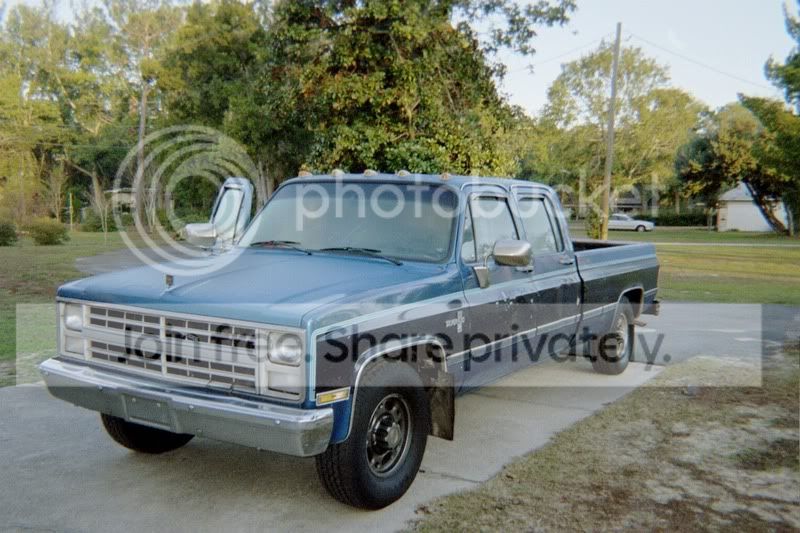

It took me about 2-3 years to find a 2wd Crew with a 6.2 to dd and tow occasionally.
With 4.10 gears and 285/65 tires, I only fill it up once a month, 40 Gallons.
I have pulled a 7k lb enclosed trailer around without problems. If you're not in a hurry, I don't see why the 6.2 won't work for pulling the Blazer, but adding a camper might be pushing it.
