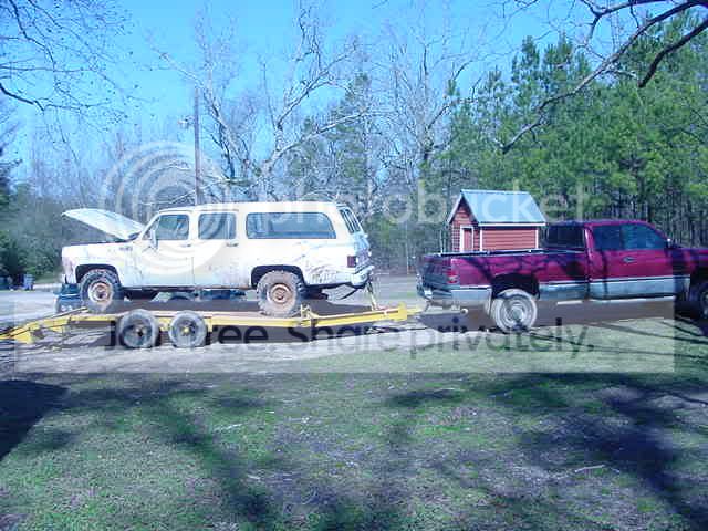

Maybe my cummins is getting tired, but I didn't feel overly comfortable with this setup. There were alot of wheels on my 70 mile towing trip, and it was drizzling rain. But I was really sweating it. It was all my truck could do to strain it up hills, and It felt like it was pushing me down hills. If I had been using a lifted k5, I don't think I would have made it. just my 2 cents.
I tow all the time with Full size trucks and dump trucks and tractor rigs. And towing more than my dads 3,500 pound boat with my 4" lifted blazer i wouldn't do. You need a 3/4 ton truck. Sure the Blazer would be fine hauling a 7 or 8k load on a great day with sunshine and fairly strait roads and no other traffic on the road. But that is not reality.
james your cummins not likey??? hmmm ..... i am sure it was pushing you tho since you got no working brakes on that trailer.....
I towed the same thing you got pictured . A big 3/4 ton 4x4 burb on a tandem axle trailer and it was hooked up to my old 74 blazer with a 6 inch lift and 36" tsl swamper :eek1: . I towed this from mt.hood to milwaukie oregon ( 85 miles). anything over 55mph the a$$ end would wag like a happy dog and stopping just plain sucked . I bet with 3/4 ton running gear and no lift and smaller 33" and under tires would have been alot better . Now I have the 1 ton cc w/454 and I have no issues with towing . Bottom line is if you are going to tow with a blazer , keep it stock height and try not to tow anything to much longer or heavier and plan your stops on hills . 1/2 ton brakes don't cut it for towing :eek1: .
