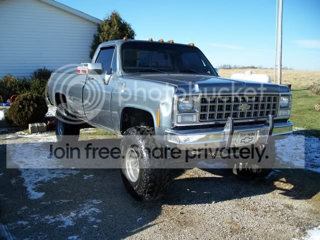

Just not a fan of the 82 grille. Part of it is that when I put a real bumper on the front I lose the turn signals in the bumper.
Oh that's true, I thought you had the '80 grille on there, that's cool, '82? no.
