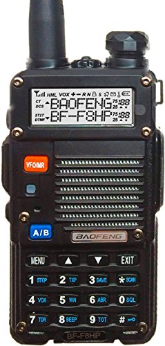

BaoFeng BF-F8HP (UV-5R 3rd Gen) 8-Watt Dual...

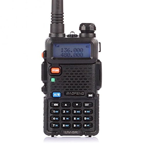

BaoFeng UV-5R Dual Band Two Way Radio (Black)

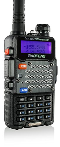

Baofeng Black UV-5R V2+ Plus (USA Warranty)...

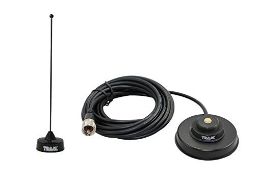

with a mag mount antenna for your truck you can have even better range
New Tram 1235 Black UHF PL-259 3 1/4" Magne...

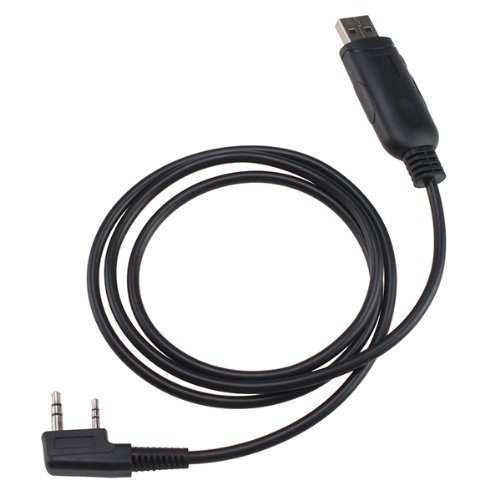

and the unit for the programming
Baofeng USB Programming Cable for Baofeng T...
I use Chirp http://chirpsoftware.com

The most important part of the install is the antenna mount (and tune!), which is the part nobody wants to do. So many types of radio get a bad rap on performance because people are using handhelds inside their vehicle. There's also a general perception that CBs sound terrible because all over the highways there's jibberish, stupid reverb boxes, over-modulated signals, etc. In my experience, the people I'm actually travelling with come across the radio sounding just fine, though.
The Baofeng radios are neat, I have one of the UV-5R radios and use it quite a bit. They do cover many frequencies that require a license to transmit and it is a federal crime to do so without one by the way.

On the radios, I wouldn't personally spend the extra money for the 8w radio. I tested one and never really saw a reason to have it. If 8w will make the trip, 5 will too. Doubling power doesn't net you a double gain, especially on vhf. Also your batteries will last longer on the 5w radio and it will stay cooler. A better antenna or external antenna will get you better gains than the extra power for the same price. I have the Diamond SRJ-22CA for mine and I'm really happy with it. You can also get an external mag mount or if you're dedicated, run a through hole or lip mount with a good external antenna and REALLY see some gains.

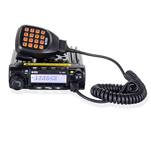

I have a 2m in the Xterra, a dual band will be going in my K2500 and I'll use a Baofeng in my K5 with a through hole mount and external mic so I can pull the radio easily since it spends it's summers topless! I'm going to build a "go-kit" to move between vehicles with a Cobra 75wxst if I need CB in either the Xterra or K2500. The K5 has a Uniden 505 mounted on the dash with a 102" whip on the rear corner.
Yea I use a mic and mag mount with my handheld. For 50w the $150 seems like a smoking deal. I was looking into a full rugged radio system and the price was crazy.
I don't like the Baofeng mobiles because of the menu driven squelch instead of a knob. I like being able to open squelch to hear better or close it to limit static on the fly workout a bunch of button pushing. You can imagine how those menus are after using a UV-5 radio for any amount of time. I've also heard of them running so hot that the fan runs is receive within a few minutes of turning it on without talking on them.
Take your $150 to a local hamfest and score a nice amateur radio then use the Baofeng HT for frs/gmrs. I got my IC-2100 for $100 with almost no use on it and my TM-707G I got for $150 with a repaired control board (squelch pot and lights replaced) with a 30 day warranty through the shop that did the work.

First, make sure the little cover over the ports is not hitting the cable plug, then take you thumb and push hard. You will probably hear a slight click and the plug will go flush with the side of the radio.
