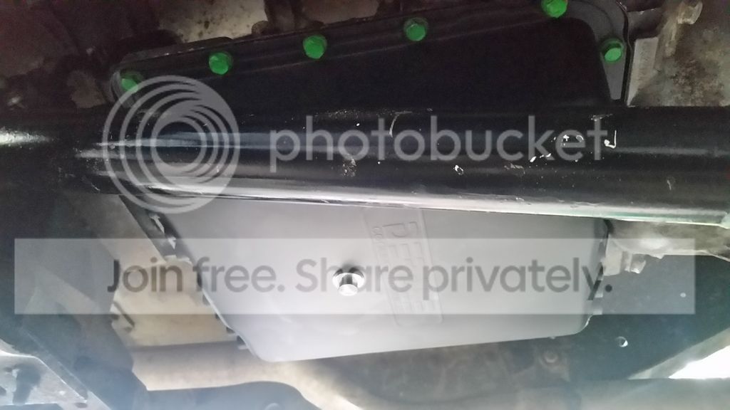

Well, got the pan in the mail. I really hope it fits. Gonna be close to that front driveshaft. Maybe I'll know for sure tomorrow... out of time today.
Pan is on, fit is good. Seems like a nice pan. I'm still waiting on the temp gauge though. Supposedly be here Wednesday.
