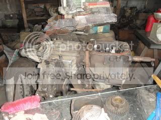

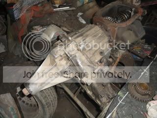

[FONT=&quot]guys, i have a 1985 k5 here in the Philippines. i got it from the previous owner who change the trans from automatic to manual. base on the what i learned from this forum to identifying trans, i believe its a SM420 connected to a NP208 tcase. im planning to get a SM465 to replace this since the 2nd gear on this SM420 is worn out. i saw a SM465 with a 32 spline output for sale, will this bolt on my existing NP208 tcase? and im confused on what adapter plate to use with this set up, will it be short or long? what input spline do NP208 have?
some pics i have of the trans and tcase:
[/FONT]
Well I believe you have correctly I.D.ed your trans & transfer case.
All 420's I have seen were 10 spline. To mate a 32 spline 465 to your 10 spline t-case would require a new input shaft for the transfer case, or a new output for the transmission.
Your combo looks like it has some sort of homemade adapter in the form of a steel plate between the transmission & the adapter. I am betting that your 208 is a 27 spline input & was the original from the T-350/700r that your Blazer came with.
If I were you I would seperate the pair & see excatly what I had. We need to know the spline count on the 208.
***EDIT: After looking again your adapter looks like a T-400 adapter so your t-case could be 32 spline input. GO ahead & seperate them. Need to see pics of the adapter you have & spline counts on the input of t-case.
