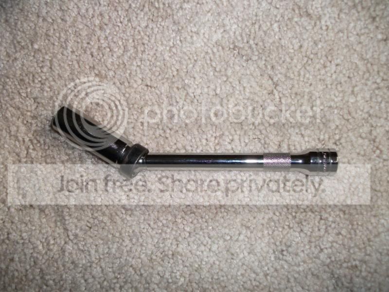

ya need better sockets.. i'd bet a dollar my Snappie med deep sparkplug socket with the built-in swivel would work...
this, but med deep...

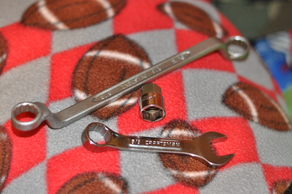

Here's what I use all the time to change plugs on my header-equipped trucks and Camaros:
The little socket is from Snap On and is a VERY valuable tool. I also have another 5/8 stubby wrench (very slight offset box end) and a similar socket that has an offset 3/8 drive on the end. Both are from Snap On and don't get used very often. The offset drive socket is VERY useful for 4.3 S10 pickups though, where the steering shaft is in the way.
