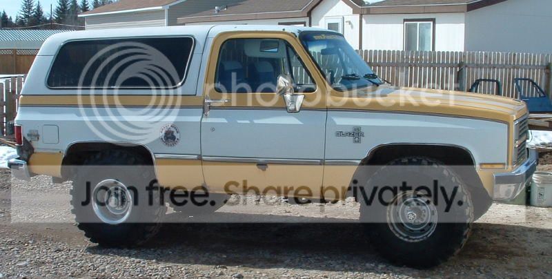

Here is a comparison between my dads 91 back in about 1999, and my 85 k5 about 2011. His had 33 12.5s and tons of room, mine had 32 11.5s, and looks like less room... All about how shot the springs are IMO.

Sorry for the crappy pictures. Here it is with the wheels and tires.
Had to trim.
Then I could turn the wheel.
Martin
