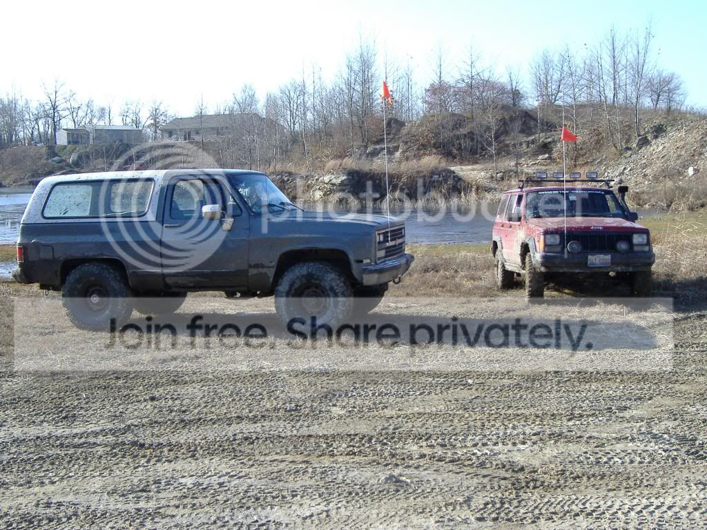

35" tires on stock wheels. No lift. No rear fender trimming. Very little front trimming. Would still rub the inner fenders a little bit but I didn't care as long as it was smooth surface that the tire was touching and not something that could damage it.

Ummm.... nope :haha: That truck looks like this now:
I did run the sway bar back when it had no lift, then when it had 4" suspension lift. I eventually took it off and left it off. Then everything snowballed :doah:

With the right backspacing, you might be able to squeeze a 37 in the back with no lift. I think my 35s rubbed the inner tub in the back. But not by much and again, it's smooth metal so I had no problem letting the tire rub on that
