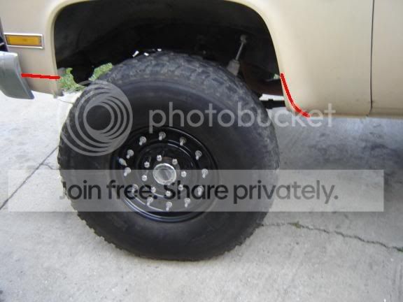

I have 4" springs on my crew cab on 37" hummer radials and I will rub the back part of the fender sometimes. Although I wasnt "trying" to flex it out as its my desert truck that I use when to haul my bike around, but Ill drive through some fairly rough areas sometimes and occassionally Ill get a little familiar "rrrrooooooommmmmmpppp" from the tire contacting the fender. But this actually is with some slight trimming, I took a few inches off the front part of the fender lip and loped it clean parallel with the ground. And slightly opened up the back part of the fender to the inner fender well. I dont think I have pics but let me see if I can draw something up real quickly......

ok here you go, this is where I trimmed my fenders. Granted these are some hard ass 4" procomp springs but they came off my blazer so the weight of the crew cab definitely makes them flex easier. I only trimmed the front part about halfway up the front bumper (I could have went higher) but I wanted to leave the stock bumper on.

I have 4 inch springs and trimed the fenders and I fit 39.5's. The top of the fender was cut up to the inner-fender, and I went a little "WACKO" on the sides but it worked. No drive shaft issues either.
that is freakin crazy! :eek1: i cant wait till i get a d60 and 14ff. then i can run some 42's and have some fun. i was going to put 42's on it with the d44 by adding a 3" body lift. then i thought to myself. this is a wheeler. do cut out fenders replace the inner fender after trimming? is that what they are for? and with all that trimming did you replace the inner fenders?
No they do not replace the inner fenders, mine are the factory ones and all after market cut outs do is CLEAN up your cuts, so you have an "almost factory look" atleast thats my take on it.
