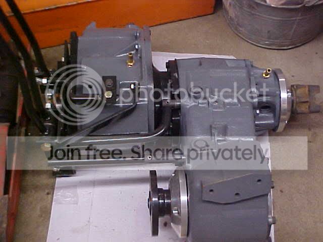

I've got home made tripple stick, but I don't think I've got any photos. Not really much to see, just a pivot formed from 4130 CrMo tube (just what I had) with a ~5" extension below that works home made linkages, and the "stick" above for shifting. Bracket to mount the pivot is just 1/4" 1010 HR plate that bols on using 3 of the 203 adapter bolts.

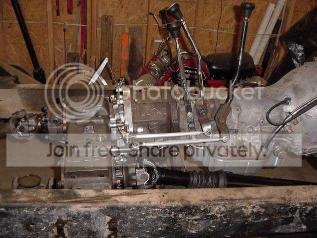

This is what I came up with for my furd 205 doubler.
I don't remember if this was from here or pirate but it's another example..
here are some of my homeade shifter. It is finished now but still on bench, I can take some better pics now
thanks guys for the pics
I like the last pic, do you have a pic of the main/ mount piece alone?
here is another old pic. I forgot my camera at home today. Will try to take current ones tomarrow if working at the shop
