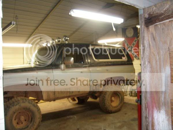

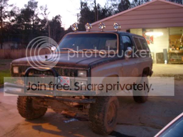

this might not fit your application but i mounted my lights directly to the cab since i dont really care about cosmetics. might not be the prettiest thing but i can SEE VERY GOOD lol

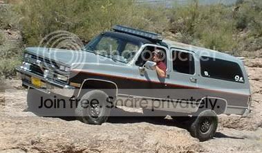

you can easily put some behind the grill, thats what i meant. and you can put them on the bumper pretty easily to. another idea would be to mount two like the jeep guys do. you might have to move them to open the hood but i think it looks pretty good if done right
that does look good, do u know if they make blackout covers for those light so they would be kind of hindin, and what kind of lights r those

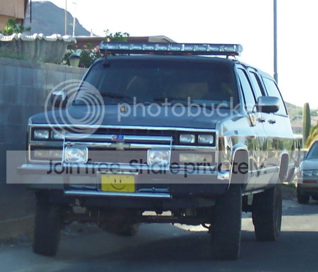

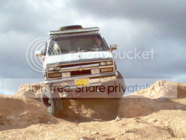

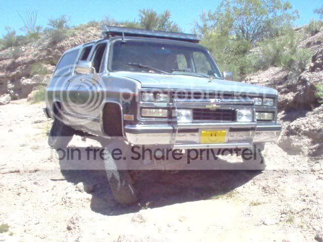

the ones on the bumper are those 6x8" with 130watt replaced bulbs bought at a 4wd shop, the overhead rack is an old "Trailblazer" i believe they are out of business, but all 10 forward facing, 5 rear and 1 each side facing bulbs were all 55watt, i replaced 6 of the forwards with 100 watt bulbs.
the lens was recently replaced with actual glass, the old plexi-glass or whatever it was, started fading, frosting and turning yellow. looks alot nicer now, throws out a TON of light, and will kill the battery even with the engine running in about 5 minutes with all 10 forwards and bumper + headlights turned on.
