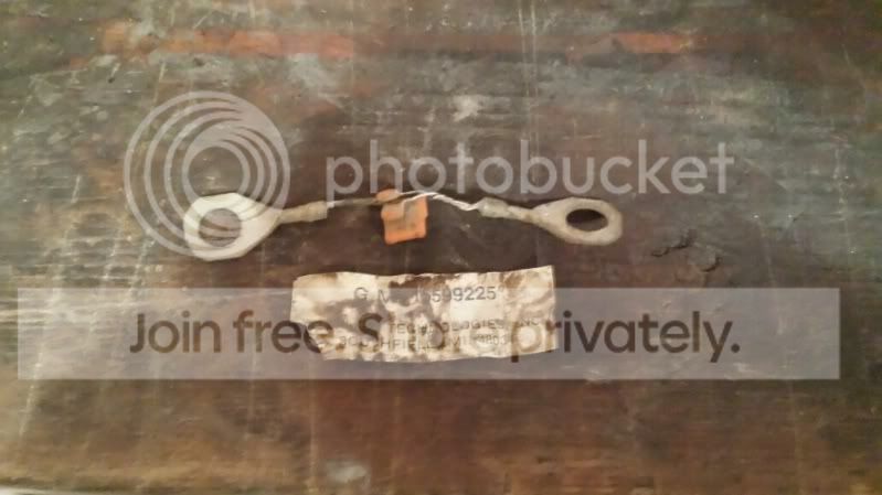

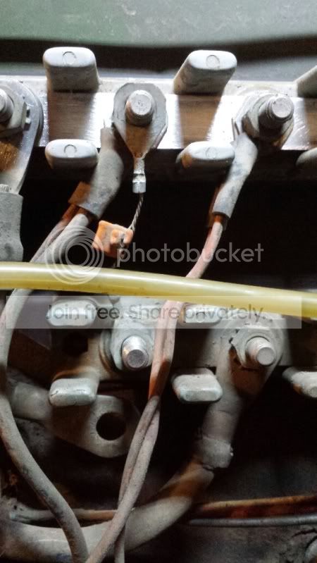

Truck is back to no start. I drove it about 15 miles the day before yesterday. No issues. Had it in the shop and went to start in yesterday and just cranks. There was a smoky haze in the shop last night so it was getting fuel. Put the chargers on it overnight and was the same again today. Seems like glow plugs aren't working. If I cycle them a couple of times the body of the glow plug is dead cold to the touch. I would have suspected them to at least feel warm? Cracked the filter vent and got tons of fuel. Cracked a couple injector lines and got fuel. Took the batteries in to town to have them load checked just in case. They are 950 cca interstate sealed batteries. Both load checked at 1200 cca. Started going through wiring today. Removed all battery cables and sanded all contacts in the junction block, engine grounds, cable ends. One thing that I did find was this thing. Fuseable link? It was wrapped in tape, I unwrapped it but kept the tag. When checked with a meter it shows that it is open. It was located in between the two junction blocks here (just set in place for photo). What is it and what does it do? I checked the voltage at the glow plug solenoid. 25.7 volts on the input side. When the solenoid clicks I get 18.3v on the output side. Is that high? I thought it would be closer to 12-13v. Checked one convenient glow plug wire and got the same 18.3v. I'm getting really tempted to go forward with the 12v swap. Now I'm wondering if the glow plug resistor pack is bad if I'm seeing 18 at the glow plugs. Plus, are my glow plugs now toast after over-voltage? Sorry for the noob questions but it's my first diesel other than tractors.
Did some more reading and will check all of the glow plugs today after church. The PO did install all new glow plugs recently per his work log. If the resistor pack is bad it would make sense that the new ones hung in there at least for a while with the higher voltage and then started dying off now that I've driven it more in the last two months than it has been driven since the plugs were installed.
With glow plugs getting 24 volts I assumed resistor pack was bad. Didn't want to hunt for one so I just did the 24V to 12V swap. 6 of 8 glow plugs were fried. Swapped in a new set. Truck started right up.
