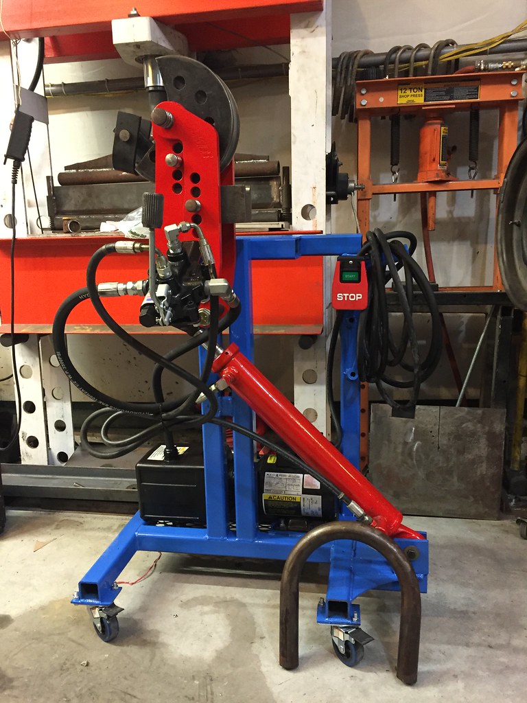

so I just recently purchased a JD2 model 32 bender w/air over hydraulic ram, and I'm drawing up plans to build a stand that has rolling casters. I'm thinking I'm gonna use 2x2 square tubing, but I'm unsure what wall thickness I should use. The bender is going to mounted horizontal, so the stand is there to just carry the weight... would .120 wall be overkill?

Tube bender stand fab'd up and bender is assembled.
Bender: JD2 model 32
Hyd ram: HF
Ram adapter kit:SwagOffroad
