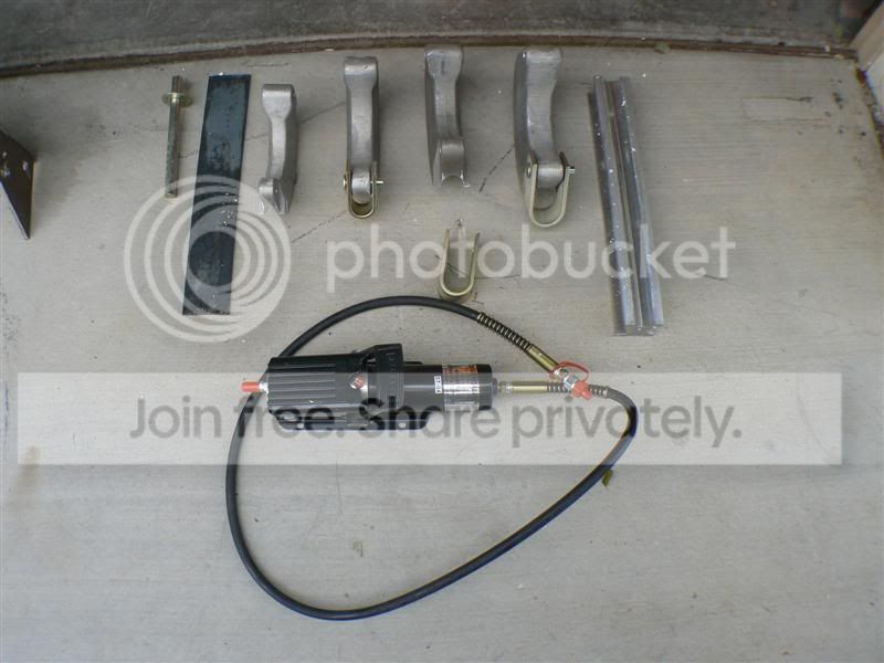

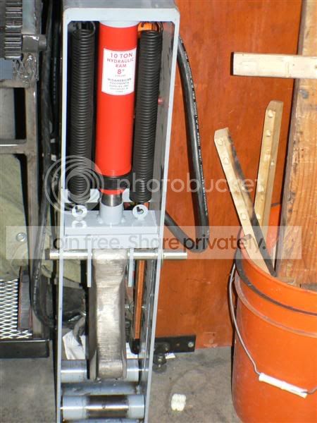

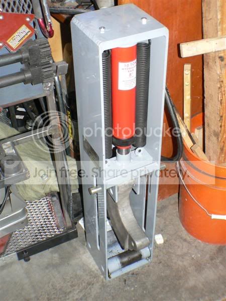

I got the bender on the 3rd. I began bending the tubing for my bumper. Quick review. This bender works great. The thing is a tank. There's absolutely no flex or movement while bending 1.75 x 0.120 HREW.
The thing came with 4 dies and a follower bar. Air over hydraulic system is SWEEEET. It is very easy to use. It also came with a short VHS tape that was much easier than reading an instruction manual. This is a dynamite tool. It is bitter sweet considering the customer service.

I like the bender. It only bends 90 degrees, but it comes with 4 dies, from 1" to 1 3/4", air over hydraulic. I built a winch bumper that turned out pretty good (in my opinion) for a first attempt. I learned someting about my welding skills. It looks like Helen Keller did some of the welding. Thank god for grinding wheels.

Here are some pics of the bender as delivered (and used)...
