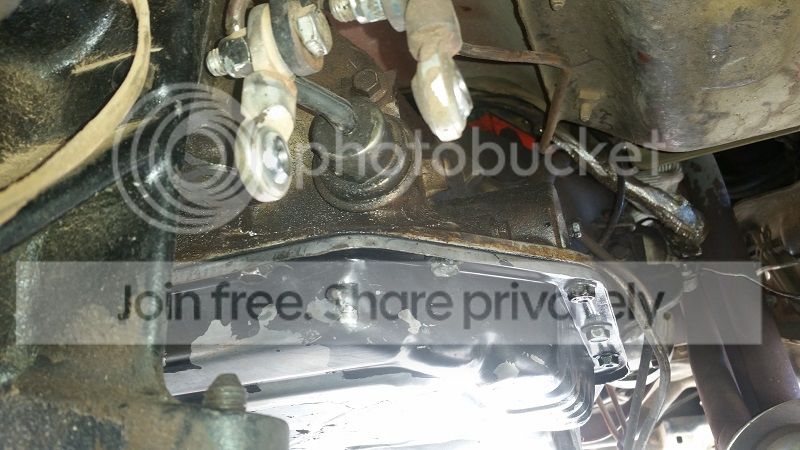

I'm sure I can't be the only person to have a twin sticked 205 on a th350. Got this truck from my uncle and he did the conversion to twinstick before I got it. Got up in today and yanked the t-case out to do a sye on it.

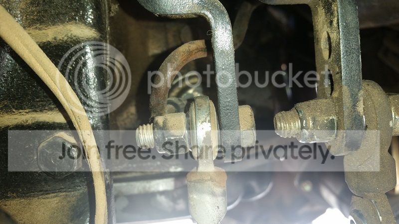

Realized the vacuum modulator/vacuum line are sharing space w/ the shifter linkage. I can swap the bolt around to the other side and that will make a small bit of space on the bottom, but the linkage is still going to hit the vacuum line. Not sure how tight I can bend that metal line, didn't know if there were any more elegant solutions, like a 90 deg modulator or something.
its just 3/16 brake line with different flare on the ends from normal brake flares.
just mod it to fit your needs and be good to go .

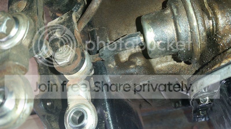

I did a longer chunk of rubber line, maybe 4-6", curved in a 90*, and then hooked the metal line to it further out to clear the shifter. It does pop loose every now and again, but I think the rubber line is getting old and hard.
Anyway, as mentioned, you can tweak the line out of the way as required, no worries.
