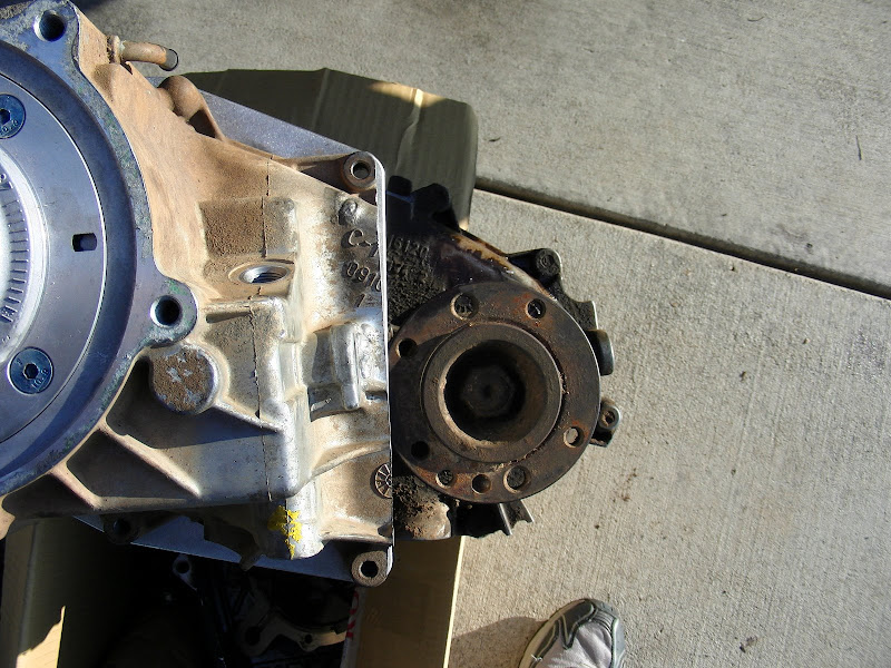

here is my kit:
mine is from D&D. its a 231 case in the front, 241 in the back. he also has adapters for a 241 as the front case.

also, as far as torque, the planataries in a 241 are rated stronger than a 205. but most people cant get past the chain, or the slip yoke. but they are certainly a very strong unit.

yeah, i have an s10 with a 231 already in it, so for me it was a natural choice. however, D&D also makes them for 241's as the front case. one thing to note, is the adapter will mate to any 6 round t-case, with your choice of spines. i have heard of people running both 205's (ford and chevy) and d300's behind this doubler. both of those can run twin sticks. i wanted twin sticks too, but i went with a better low range instead, plus i dont want to have to lift a damn cast iron case above my head to install the stupid thing.

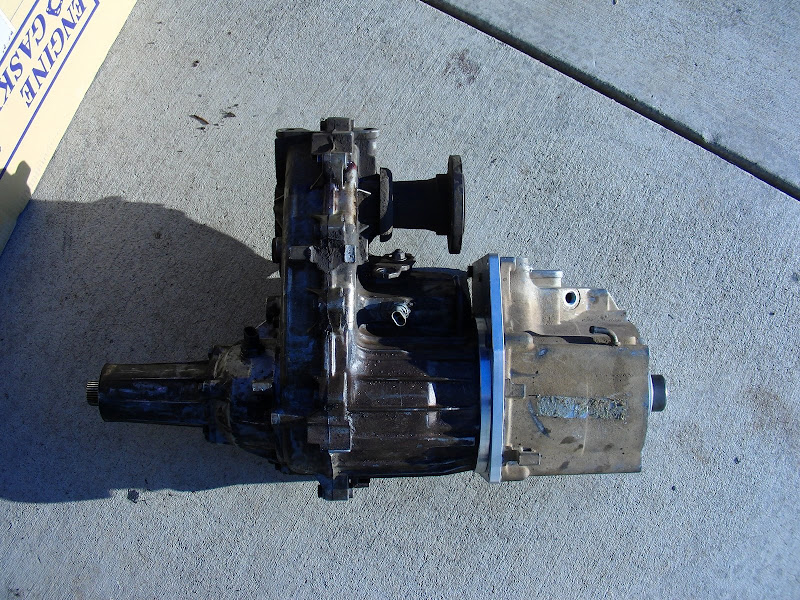

this is my setup:
ive got two drivers drop cases, and the second case it clocked the same as the first. i would have to flip the first case if i needed to clock the second case down, to clear the driveshaft and the first case/adapter. but, i have a 231 front case, and it looks like the 241 is cut a little different, perhaps to give it more room for the driveshaft.

no, the 231 is cut between two bolts holes, to get the best sealing surface. it would be a lot more work to re-due what the manufacturer designed it to be. plus, i dont need to clock down my particular application, so i should be ok for a driveshaft.
