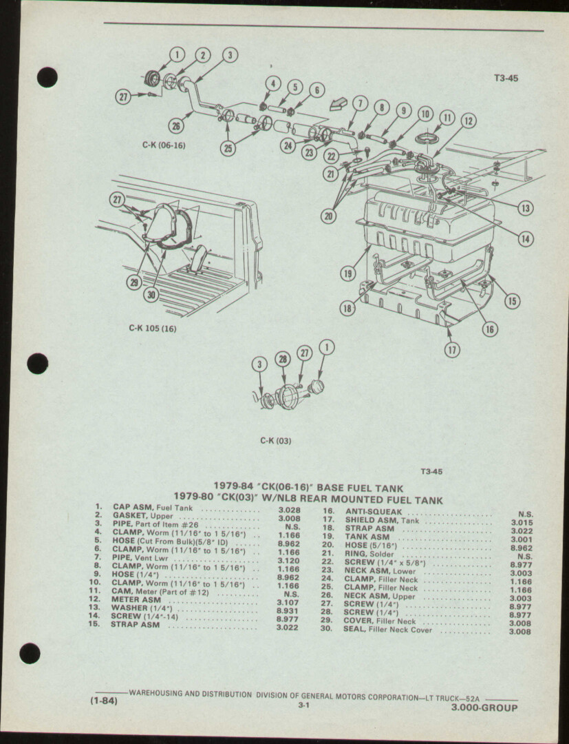

GM did have a somewhat rare factory option for a rear mounted tank for pickups. Not sure how easy it is to find those or if anybody makes those, I'm sure somebody does, they are slightly different than a burb tank so it might fit easier with the existing crossmembers.
(click to enlarge)
06=Blazer 16=Suburban 03=Pickup
When you look at the actual part numbers, there are three different tanks for each of the three models. The illustration here is just "typical' installation so a parts guy can look up service parts.
I think it was offer either as the only tank, or it was used as an aux tank without a switch valve. That it is, I think they just put a lift pump off it and had a switch in the cab, so when you saw your main tank level getting low, you would flip the lift pump switch and it would transfer the fuel from that tank to the main tank. That's a good setup if you really want three tanks too, because the plumbing can get trickey with three tanks.
they list that rear tank in the lmc catalog. listed as a 25 gal tank I think.
