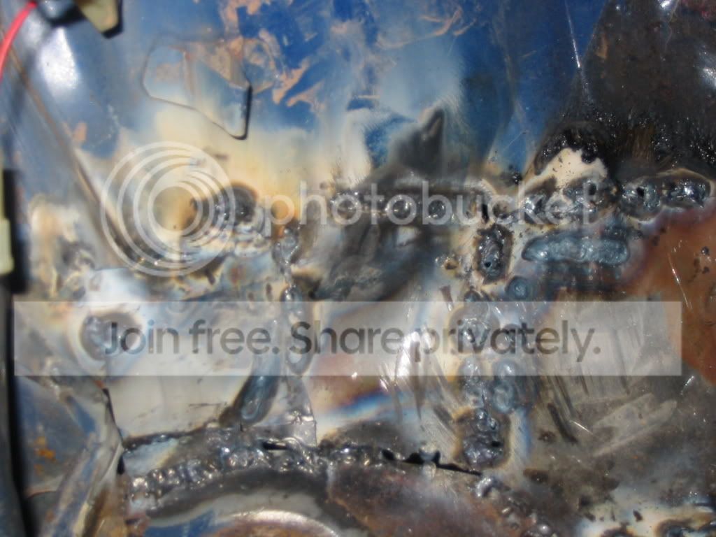

Since you know so much what do you think of these welds :rolleyes:
