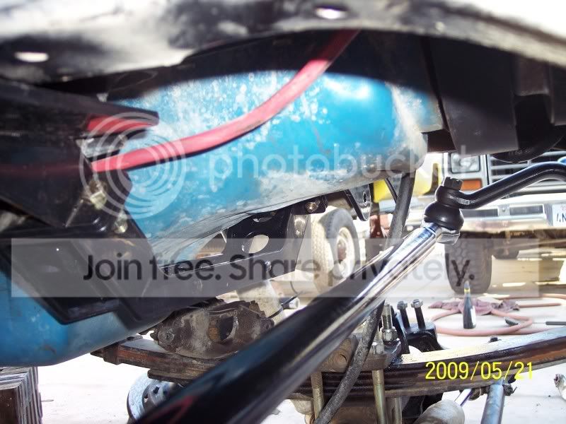

Here is a pic of my gen 3 motor showing the crossmember you think yours will fit, i am in need of upgrading my tack bar so i am looking into my options
I was doing all the other mesurments for him and if you take a pic with a straight edge under the motor mount brackets that is where he needs to see the clearance. The front cross member comes out when you install this one.
1979jimmy350, mnstrburbon is correct, post a pic of the underside of your oil pan near where the motor mounts are, and we can decide from there!! Thanks!
