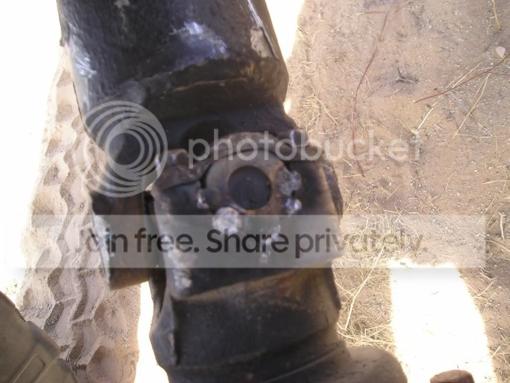

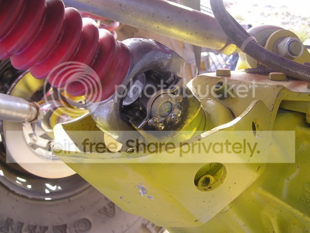

Stock 1350 style 14b yoke with straps. The straps stretched out, which lead to the retainer tits getting blown off the yoke. They had to weld the washers on in place of the tits to keep the caps in. This happened on two rigs on this last weekends trip to the Hammers. Willyswanter and another rig, Dozer. The first pic is Dozer, the second is willyswanter. Repairs were made at camp that night. I think there are some things you shouldn't try to skimp pennies on. Driveshafts, electrical, steering, brakes etc. If any of thiose things riuned my fun, I'd be pissed off. Step up to the 1410 stuff...All about piece of mind.:wink1:
