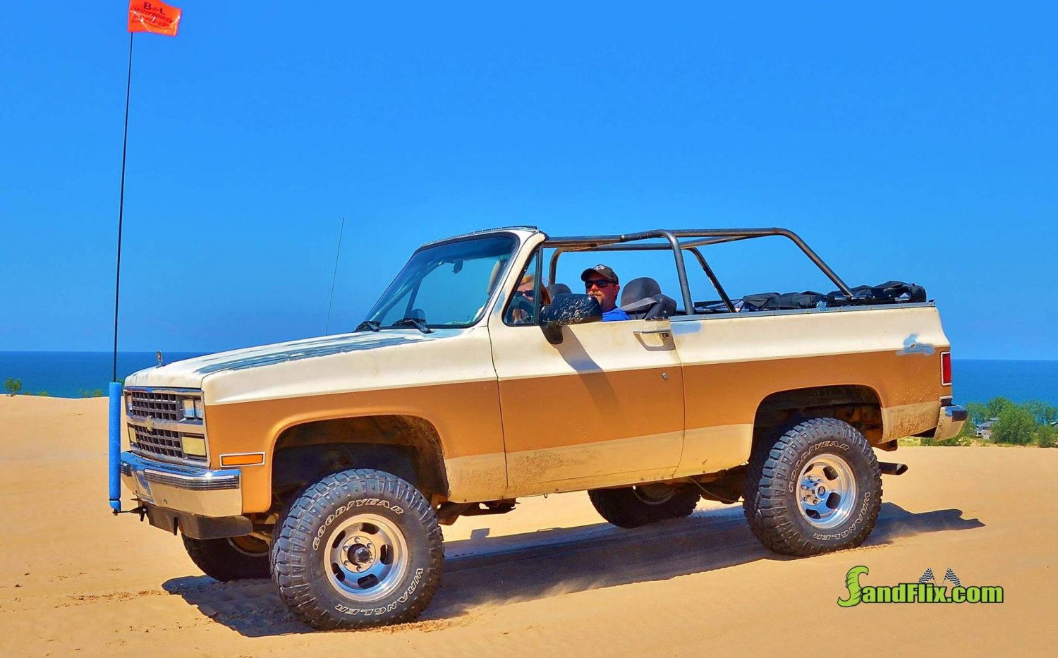

So it's been a long time without an update on this thing!
I did get everything put together and had a great time at Dunefest!
There hasn't been any additional work done to the cage or truck really since then, just been enjoying the topless ride occasionally. I still have a bunch of tube to bend up and finish the cage with, that should happen this spring.
