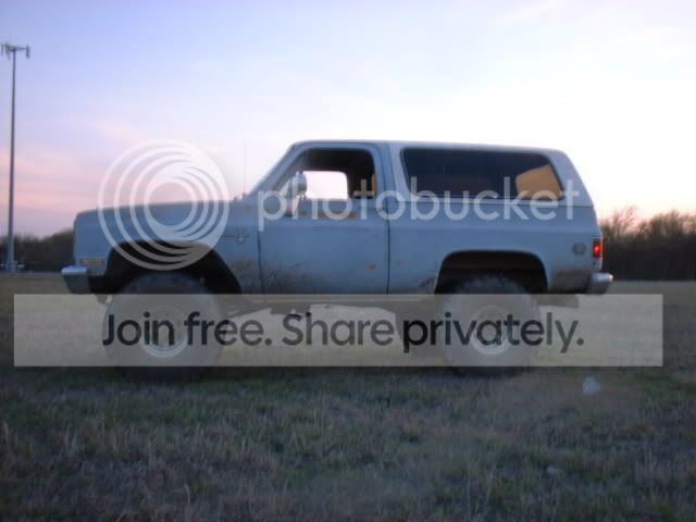

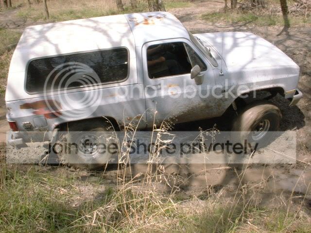

I'll post some pictures tonite when I get home from work. I've already trimmed my fenders even with the inner wheel wells on the front like citizen's truck. I'm stock right now with 33x12.50's so I had to trim. I just wanted to do the 4 inch lift to not have to deal with driveline angle issues.
Do you guys think I'll be alright with the way they're cut now? Also, I know the zero rates can be used for lift but what is the purpose in moving your axles in or out? sorry for all the dumb questions just trying to learn. "there is no such thing as stupid questions, just stupid people". thanks.

I would think your rear wheel cutting is fine. But in front you will need more cutting at the part by the cab. But once you get the tires you can figure it out from there. How i did mine.
