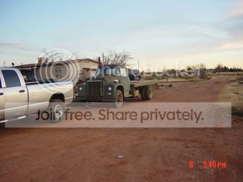

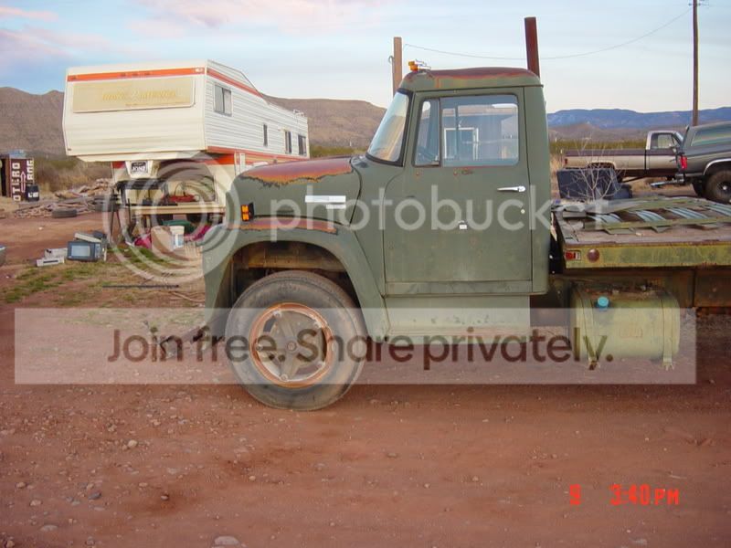

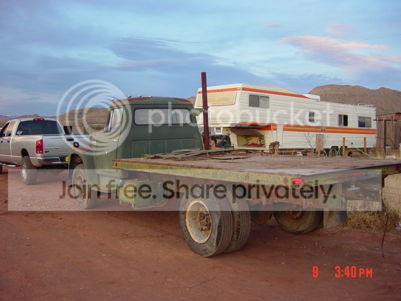

:D here's my latest pile for some inspiration
I have a DTT466 and a 13spd ready to go in this truck and hopefully some 5-ton 6x6 axles to go under it
Definitely cool...I REALLY want a crew cab though.
WHERE ARE ALL THE TREES AND WHY ISN'T THE DIRT BLACK!?!?! :D
were trying to make a deal on a no rust crewcab for this truck but the guy is being anal on the price he wants 400 for the cab and so far I've only got 250 into the truck I traded a running 454/th400 for the DT466/13spd combo . let me know if you want me to find you a no rust crewcab chevy body there all over down here and I'm coming up to Minnesota in June
