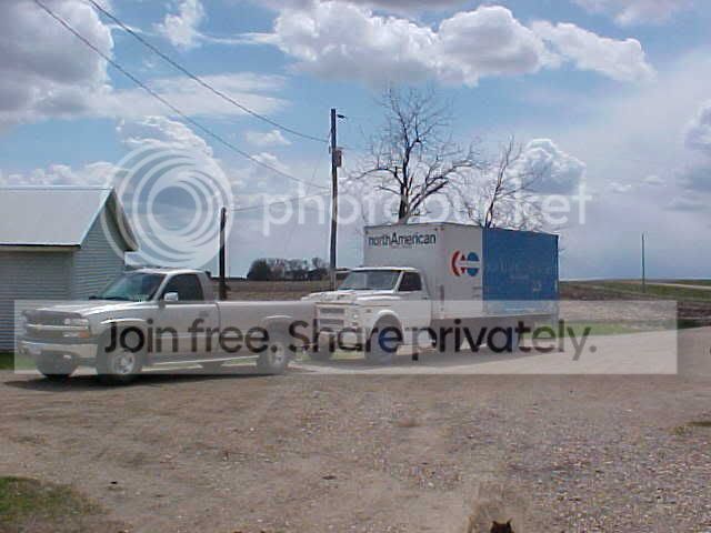

here is a good picture, and why not keep the medium duty rear end?
That bitch is TALL!!! :eek1:
Cool lookin, but I wouldn't wanna drive it cross country.
