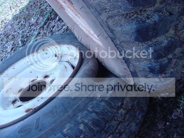

Well, I was telling the truth on the second part of the title at least... I thought everyone told me that 16.5" wheels were the easiest in the world to remove and mount tires on... Why in the world can't I get this tire off.. I jumped up and down, pryed with a tire tool, and pryed with a huge metal bar. Was I supposed to not let the air out before I began this? I just don't get it, its really driving me crazy :eek1: I just can't get the bead to unseat! Help me get these tires off and the new tires mounted on (I sure hope it isn't harder than this).

Sometimes they can be hard to break the bead on if they are old. Try a big sledge hammer and smack the side wall as close to the wheel as possible (don't hit the wheel)
16.5's pop out real easy cause of the bead. not sure if the pop in as easy, i would think so but i :dunno: i thought chevy put a safety lip type deal on some 16.5's:confused: also old rubber that uder pressure against metal that gets hot and cold expands and contracts, etc etc can form a very good seal. im sure youve taken off old radiator hoses? i know theres no 200* water going through the tires but sitting and baking in the sun dont help.

On my motorcycle tires, I place a 2X6 under and on top next to the wheel. And use a jack to break the bead, driven on once, but the jack worked better for them.

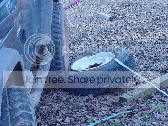

Yep, take all the air out. There is a metal core that sits sown inside the stem after you take the cap off, it just screws out. With the stem in, when you push on the sidewall it will "build" pressure in the tire... forcing the bead to stay on. I would let it out and hit it hard with a big sledge, or use the board and drive the Jeep on it. Place the board as close to the wheel as possible.

well, I did try to drive the jeep on with the board earlier too......and I tired letting air out of the tire when the jeep was parked on it... I don't think it could possibly have more than 1psi left in it.

what happens to a balloon when you squeeze it even if it has only a tiny bit of air? First step to breaking down a wheel and tire when I do them is also just remove the valve stem core with the appropriate tool and wait till it stops blowing air. Even after you do that, leave out the stem and that is one of the last things to go back in. As soon as you push on the tire with the tire remover(on a machine) it blows a puff of air out of the stem, that is air you are trapping in the tire. Not that I haven't removed a tire without removing the stem, you just got one thats happy where it is.
I've had some old 16.5's that had been on so long that my Suburban or Crew Cab sitting on them wouldn't budge, even with the valve stem off. I've used sledghammers and all sorts of different ideas before. Besides the few factory 16.5 rims that did have the safety bead, I've found most stubborn ones have rust that seems to be holding the tire bead to the rim. Just years of condensation I guess.
We had a tire once that was on so bad we sawzalled it all to pieces down to where only the bead was left on the rim and after we finally cut through it, it was still extremely hard to pull it away from the rim.

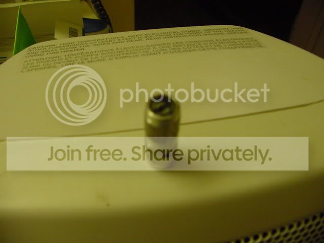

It's just a couple bucks for the tool, and them sten screws back in real easily... so if it turns hard you may have it going in wrong.
super easy, the tool is like 2 bucks, if you can put a screw in with a screw driver you can do this

this tool?
My dad got to looking around.. is this the correct tool?
