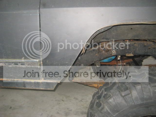

Finally cut the fenders...pics inside
This was after the front cuts, and before i painted the rims black. im glad i got the 38's! but i decided to get the zero rates for the rear.

Trim it like you mean it man...if your trim job was a tattoo it'd be a delicate little flower on your wife's ankle.
~4" of lift means without the diff moved forward you're gonna have the 38's hitting the firewall/floor area under compression. Trim it to suit that.

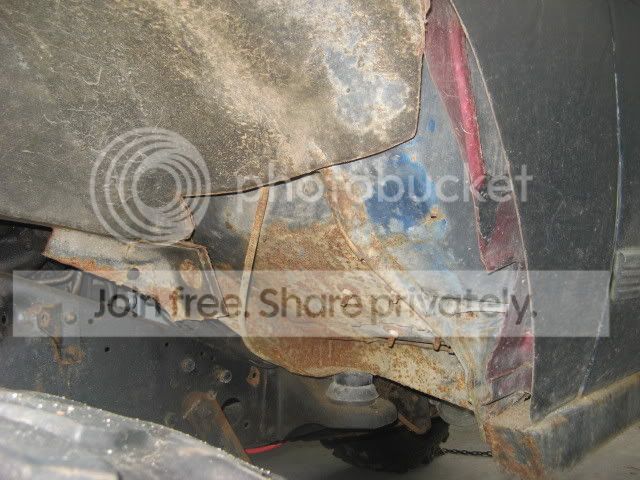

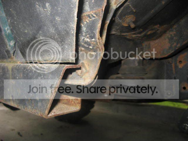

Unbolt the bottom portion of the inner fender and you can push it back to the firewall gaining you about three inches if not more. I removed the bottom 10" of inner fender altogether...this kept the portion that keeps mud and water out of the engine bay, but got rid of the part the tires would hit (potentially)
Snapped a couple of pic's...
This one shows my 'limit' for fender trim. There is a structural anchor point at the bottom of the fender that I leave. There isn't much gain cutting farther back than that anyways. You can see the square mount nut in behind the 3" x 3" tube there. Should be a good reference point for when you go compare with your truck.
This is my inner fender cut. Again I keep the large mount point (bottom left you'll see the inner fender mount bolt/washer area) and the rest I trimmed to suit while keeping the splash guard functional. You can also see the body seam hammered over to keep it from cutting my tires.

sweet. that was what i was looking for. i didnt think of bending it out of the way to continue the cut, duh!
