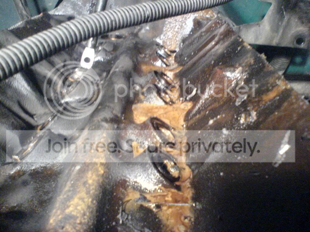

I took some pictures when I replaced a blown head gasket back in 2007. I see some holes in there. Can you confirm if this block in fact can be converted to roller cam? That would probably change my plan to keeping this engine and just upgrading to roller cam. :waytogo:
Yeah that's def a non roller block. Could do roller retrofit though?
I was talking about mechanical pumps, which doesn't apply in your case. Lol.
I figured it's an old style block. You had me for a while though.
Yeah I could do the retrofit, but that's when I realize that getting a 5.3 becomes cheaper, and already has roller cam and better heads.
