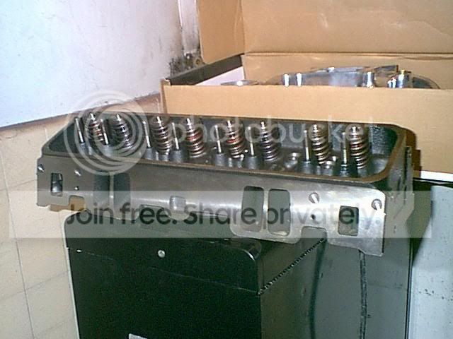

these have 416 casting cyl heads,which are A VERY good casting,and respond beautifully to porting,im used to the fbody world{camaro-transams}so im not sure if your 87 305 will be roller,if not im sure its one peice rear,and at least has the spider holes drilled in the valley for the conversion to roller cam/lifters.

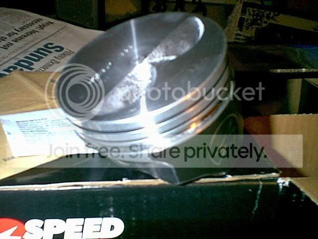

you could always do the vortec swap,and use a domed piston to keep your compression at 9.5 to 1,or possibly go larger in CR.its all up to you really and what YOU want the engine to do. gimme some more info and ill give you my thoughts and opinions.

comp beehive springs are about the easiest way to increase valve lift capabilitys in vortecs. the stock ones suck pretty bad,and you will float a valve if you go above and beyond the 5k rpm mark very much.

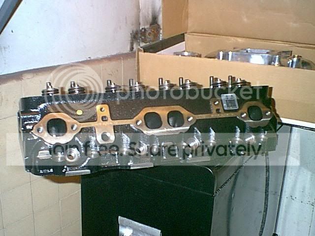

heres a few pics of my personal stuff to give you an idea of vortec ports

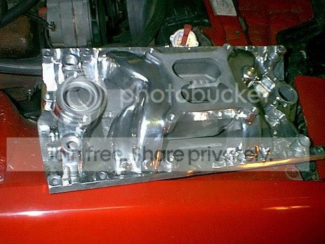

this intake works VERY well,and is cheap,had it for about 3 years now,zero problems,look on ebay for professional products cyclone? something like that.
these pistons are what i used on the 305 i jsut tossed together for my transam after my good motor blew up,from speedpro there 2 valve relief skirt coated flat tops,keeps the compression the same if you swap to a 64 cc head from a 58 cc 305 based head.

also,vortecs respond the most to exhaust porting,you will pickup a few ponies from the intake ports,by gasket matching,but nothing like you will if you base your time working the exhaust side of the ports.

I recomend a Lunati Voodoo Cam and an Action+ intake manifold. That should wake your 305 up a bit. Also run a higher compression by using dome pistons and those vortec heads. Should be a pretty good combo.
what is the difference between that intake and the power+ ???
I have the power+ and got it new for $120.. sure better price than edelbrocks $245 price at summitracing:wink1:
yeah i got my fully polished cyclone,which ias basically a edelbrock RPM air gap,for 145 shipped to my door. they might be cheap,but htey make good products.
the power plus is is also a professional products intake aint it root?
the combustion chambers on Vortec heads are designed to be most efficient with flat top pistons. going to a domed piston would actually decrease their efficiency, and would adversely effect performance.

and you would also be correct about them being designed for flat top pistons.
