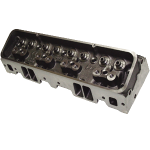

These are what i was after!
http://www.competitionproducts.com/...v-SB-Vortec-Heads-Pair/productinfo/ENQCH350H/
EngineQuest Performance Chev SB Vortec Cast Iron Heads
Developed using racing technology, with a superior port finish for increased flow. Outflows the popular GM 906 casting. Manufactured using the highest grade cast iron. Improved design to reduce cracking. Thicker decks for greater strength. Redesigned water flow for greater thermal conductivity. Tall machined valve cover rails (eliminates leaks). Includes hardened exhaust seats, 3 angle valve job and a 25 point quality check on every head.

The pics are obviously not the same head, as the description states "with heat riser" and those pictured do not have a crossover, which is what I assume they mean. Need that to run EGR, if emissions is a concern.
