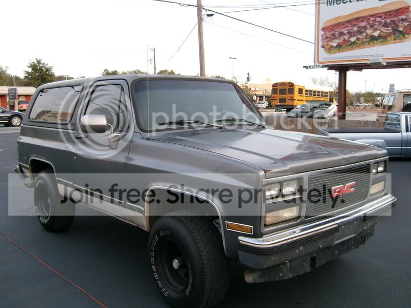

Gaffed said:
Bigjbear, whats done to it while in that pic?
Stock 350/TH350/NP205
10B/12B with 4.56:1, open front & Detroit rear
4" Skyjacker Softride springs front and rear + 1" block in the rear to level it out (I would have been better just doing a flip in the rear- live and learn)
35x12.50 BFG M/Ts on stock 15x8 rallies
Rhinolined from the firewall to the tail gate, a CUCV brush guard, trimmed fenders, bolt on steering box brace, and sway bar disconnects
Picture is at the top of Bell Mt in N. GA.
Bigjbear , How much did you trim off the fenders? After my 33`s wear out I`m thinking of going to 35`s.
In that picture, not enough. I just trimmed a little when I first got the tires, but after I un hooked the swaybar I found I needed to go further. I beet the inner fender back as far as it would go and trimmed to match. If you move the axle forward you can trim less.
