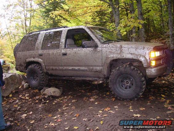

Hey guys im looking to swap my 14b FF axle under my 6 lug IFS truck. So i need to convert the rear Full Floater to 6 lug. Anybody have some machined hubs and brakes laying around they want to sell? or even some 8 to 6 lug adaptors possible? thanks let me know.

And from all the reading ive done the 8 lug front IFS swap isnt bolt on or easy at all. The Cv shafts are different, knuckles are different, ball joints are different, Control arms are different. So it isnt bolt up by any means and requires fab work. Which i can do but converting the FF to 6 lug is much easier and a bolt in install so no worry about have to DD it and all.
ummm three letters....SFA
why on earth would you want a 1/2 ton ifs front end and a 1 ton rear end? that just dont make no sence...
Trust me SAS is in the plans. I have a Dana 60 and 14 bolt sitting in my garage waiting. But i am in college and the funds to do my SAS how i want it arnt available for the tiem being and for the forseeable future.
As for needing a 1 ton rear axle, i have a 10 bolt with a detroit locker, and have blown 2 axle shafts. And since i have the 14 bolt sitting in my garage then if i swap it in i wont blow axle shafts. Then down the road when i SAS i can go back to 8 lug out back and resell the 6 lug hubs or spacers or whatever.
This is the truck:
