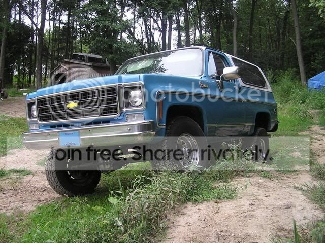

Those are a guess-timate of the stock position. I've got one decent picture left of the "before mods" bumper. Let me link that one so you can see how low it used to sit. Give me a minute to post it.
Over the course of a year or so. Before mods & after mods to the Warn. You might have to look close but these are the best I have left on file.
From the exact same measurement point - lower valance lip.
7" horizontally from lip to bumper outside face.
4" drop from lip to bumper base.
Upper flat trim panels have been reduced by half - no trimming to main bumper body. You could tuck it up tighter but that would probably not leave much room for a winch.

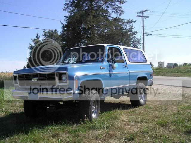

by the way if i get one here is the truck its going on.
Pic Whore Time:D
