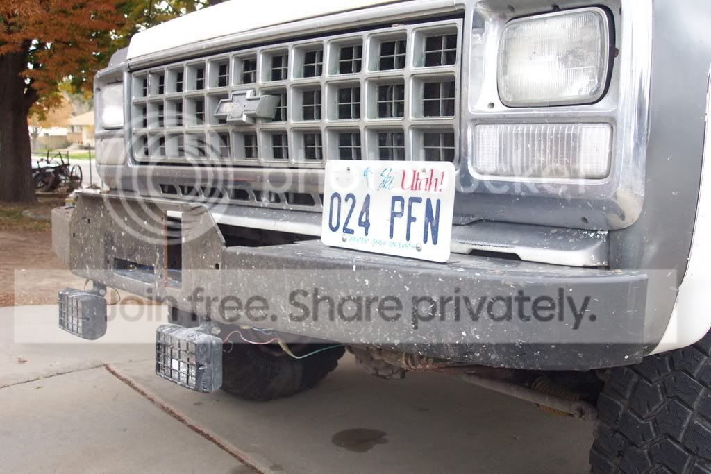

One like this?
They're pretty flimsy and don't have great clearance but they're generally pretty inexpensive.
that might be the one, the pics a lil dark tho...........thanks...........is it strong tho for the winch...? i wana put a new winch on my truck

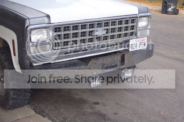

I have the same one. I dont have any pre modification pics on this computer of it though. The center where the winch mounts and what holds it to the truck frame is plenty strong. The outer edges that extend from the center are very thin and weak. This is what I did with mine. Like I said... No complaints about the center winch mount portion of the bumper.
This is the only other picture of the bumper I have in my photobucket account and its kinda dark too
The winch plate part of it is very stout and I still have that part on my truck. 25 years of abuse and hard pulls with no complaints :pimp:

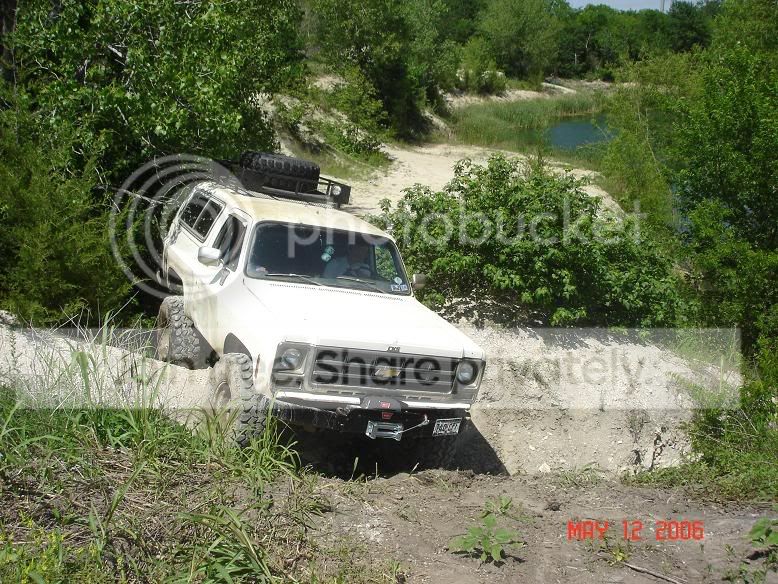

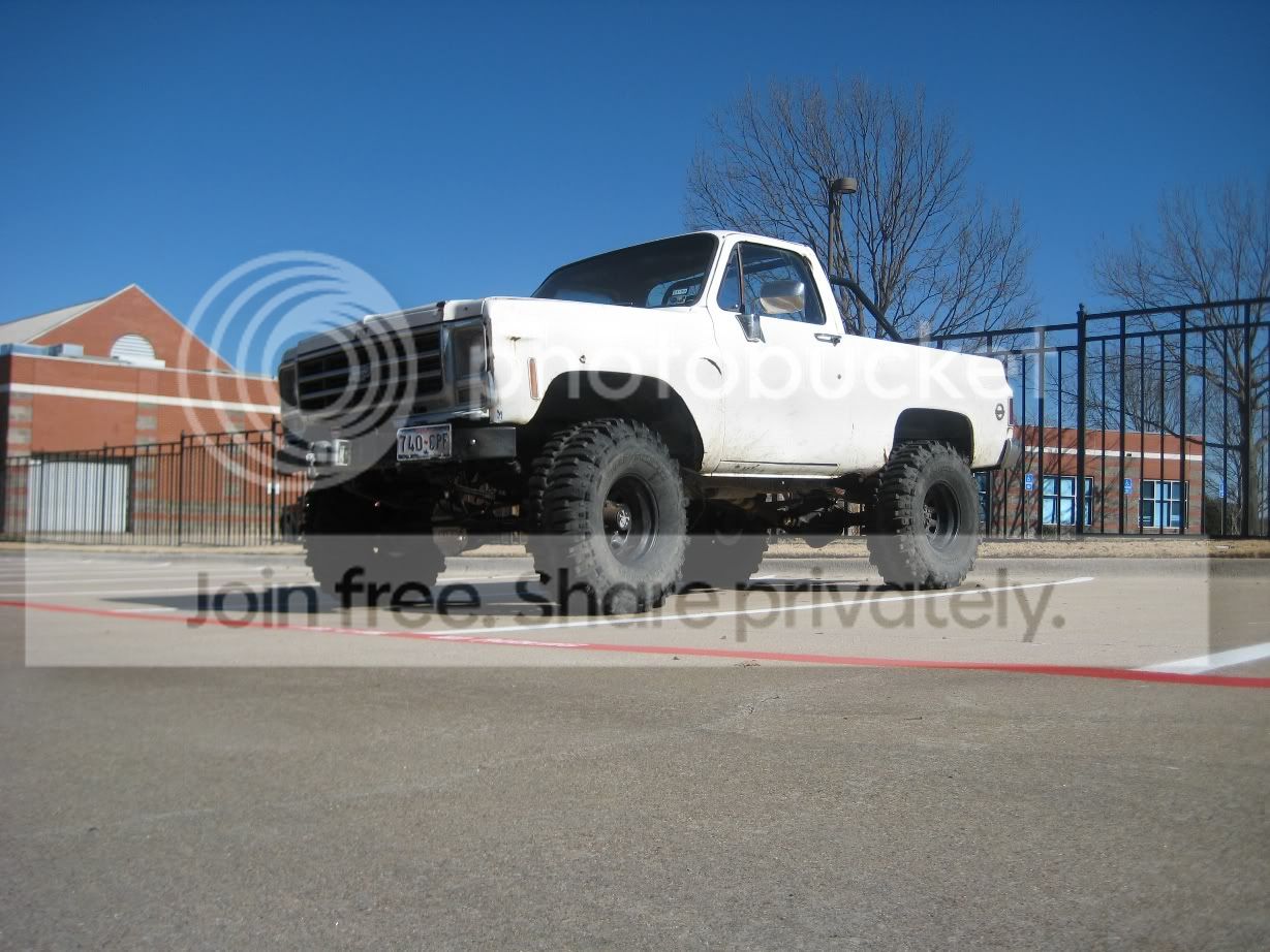

Here you go. Like DR said, the center is plenty strong, but the outers (outside the frame rails) are pretty flimsy. I never had a problem winching from it!
