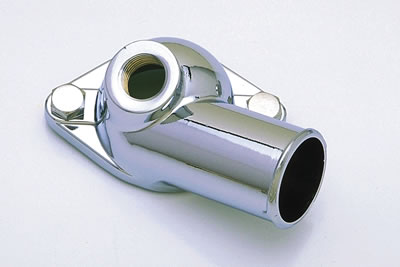

you can also get a waterneck with a 1/2 npt port in it if need be...
something like this...
