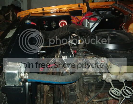

I haven't tried it on my K5 not do I know if they fit older intakes , but my IFS rigs 5.7 has a neck and hose that puts the hose in the middle of the radiator , then goes along the top of the radiator , and then 90's into the radiator neck .
I thought about that design, but I already cut the bracket and will re-weld a portion of it back on in a different location. That will put the tensioner right there.
I need to get the hose over to the drivers side then straight forward into the radiator.

I just went through this when I found my upper rad hose was rubbing against the York pully.
Goodyear hose # 60703
I'm not a member here anymore, so I can't post pics direct. Email me if you want pics of how it routes. bnate @ Yahoo dot com
For my blazer I made one with a cut flange and a piece of 1.75" DOM tubing bent to the shape i needed. Just another option for ya.
