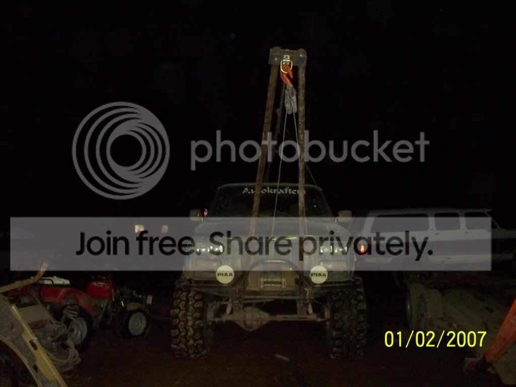

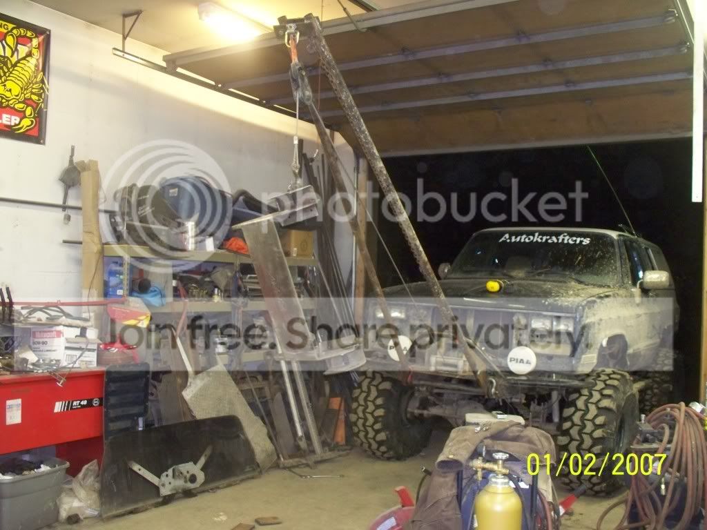

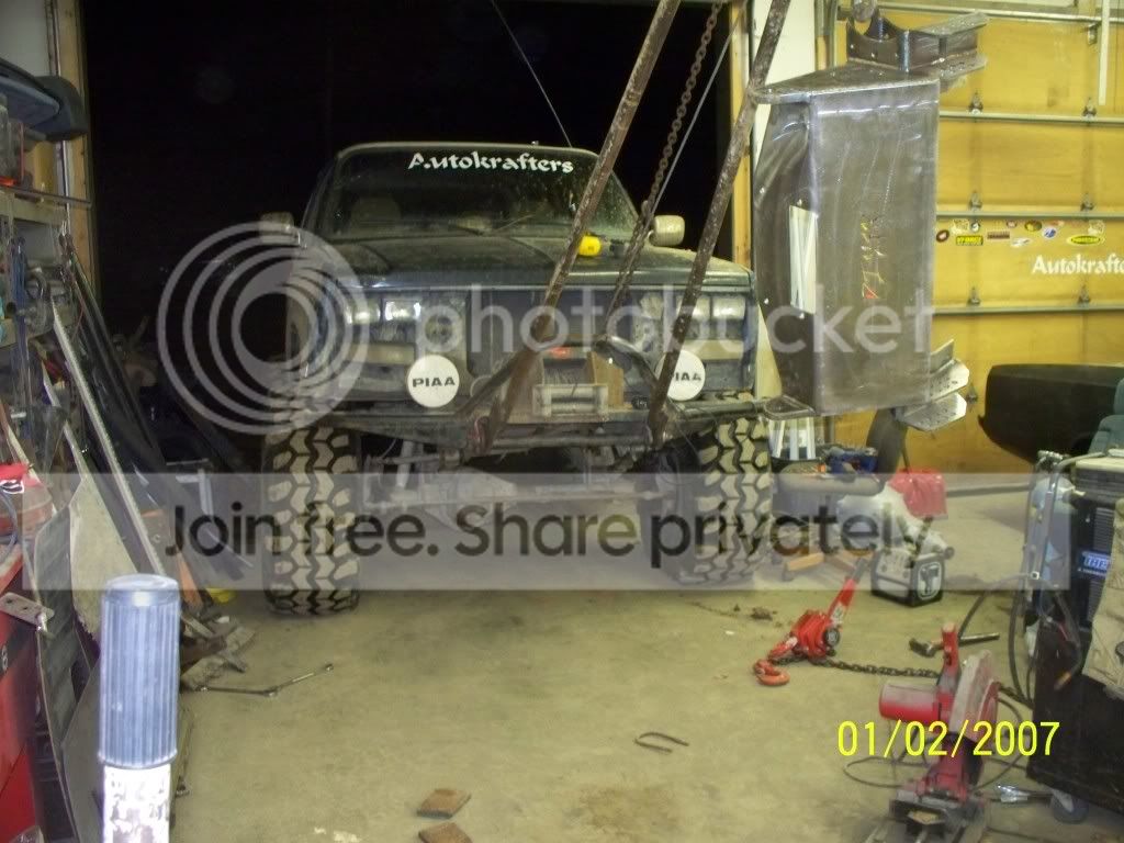

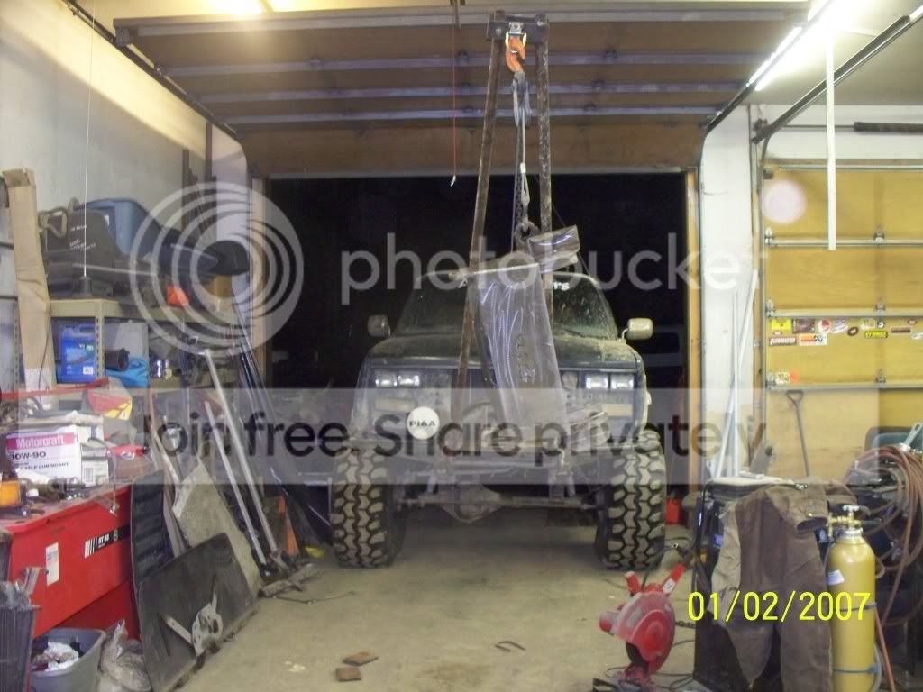

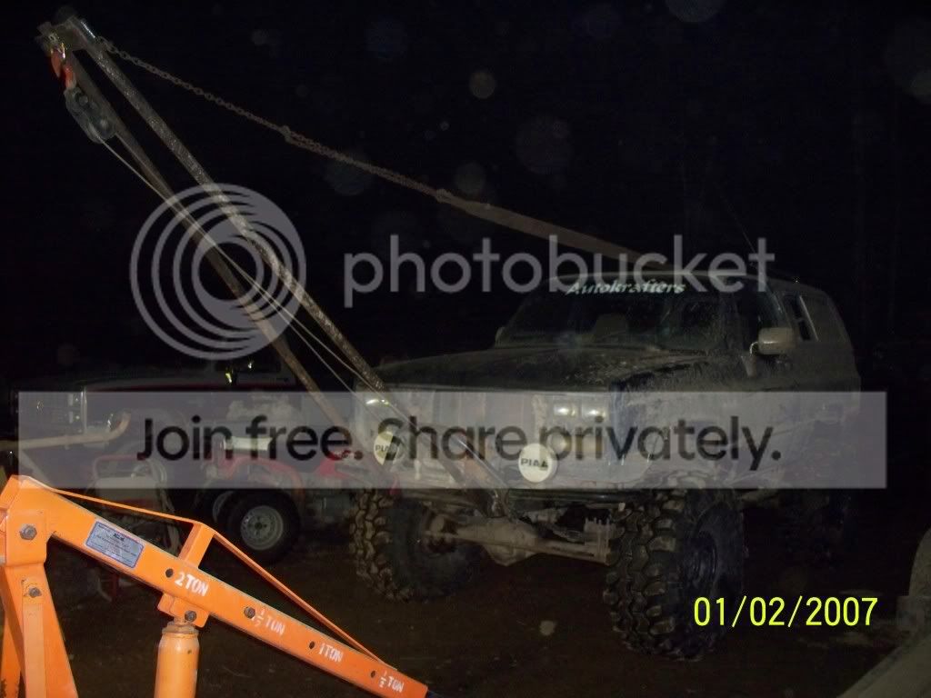

so we built this-yellowk20 and i
decided to test it out
full dressed d60
Looks good, we made something similar but for the rear of a truck to go in the receiver. What are you anchoring to in the back of you blazer?
for now we are hooking it to the trailer hitch with a shackle.later i will build tie down mounts on the roof.
You guys get that idea from some of them posted on Pirate? very nicely done. If I had a yard with all my stuff in I would build one too. Very handy to have. Thats what I call an Over the Winch Anti-Gravity System :wink1:. Good job.
no didnt get the idea from pirate.have seen them on buggys around here since i was a kid.we just finaly got around to building a set.
the bars are 1.5" sch 40.

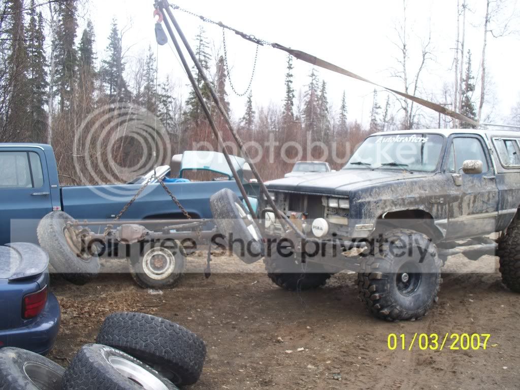

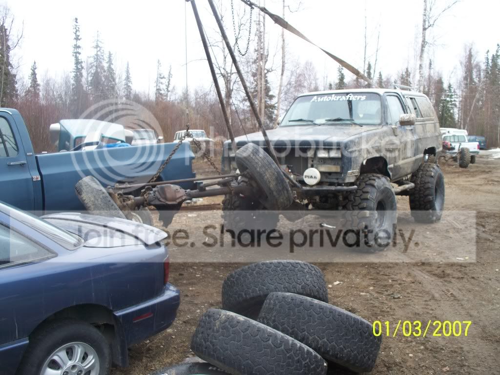

first we decided to weld the rear diff and fit a set of 42s to gus's girlfriends truck so he could wheel it-he did ask permission first.
after that we decided that the international crew cab i got as a freebie needed and bit of lift and a d60 front axle.we ended up with about 6" of lift and moved the axle forward 6" or so.we put my 44" spare on it to see how things fit.this is at ride height.24" frame clearance plenty of room for turning and flex.we used a set of chevy front springs to move the axle forward and moved the front mount.here it is mocked up.
