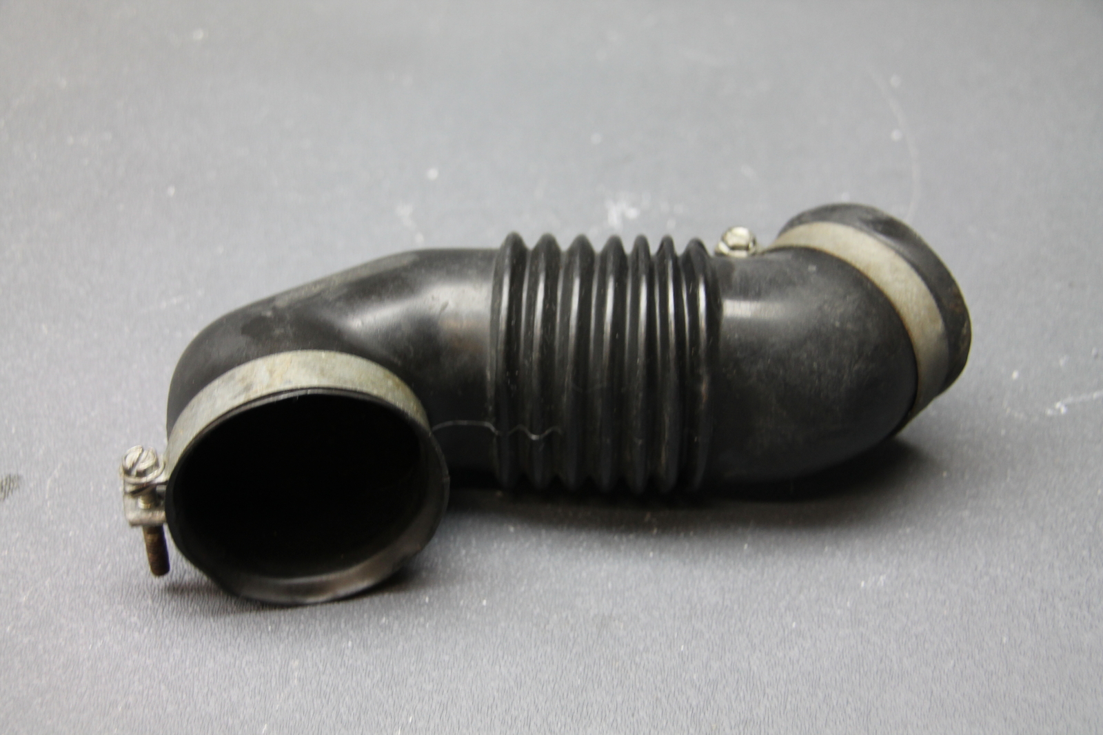

Just bought this intake tube that was missing. So now the factory intake is located under and infront of the gas tank.

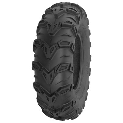

Also pricing some tires. Something that doesn't look so.....ghey.....
Looking at these with a 8in wide front and 11in wide rear.
